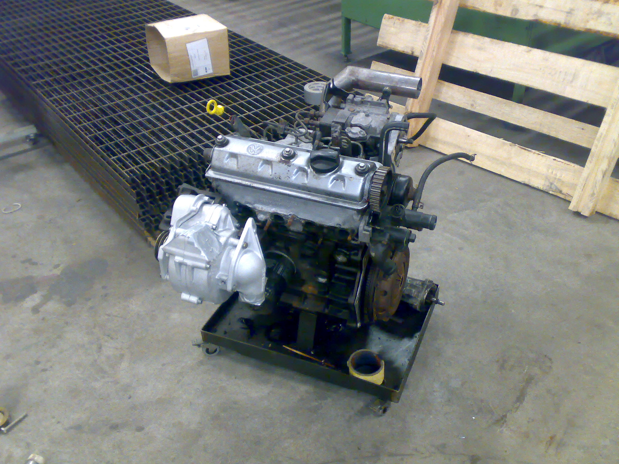

Have all the parts in the above picture for my g60 setup , but must be ran the way the lower picture is, to spin the water pump correctly.  Will be assembling on my enine stand tonight.

Is that casting above the alternator the stock G60 super bracket? and does the alternator usually live there on the G60 as well, with stock brackets?  I think a kompressor is my best option in a heavy vehicle (with electric clutch cutout for highway economy).

Quote from: "Vanagoner"
In the first pic yes.  I believe the m62 would work in one of those brackets, with some sort of adapter and the right length pulley.
