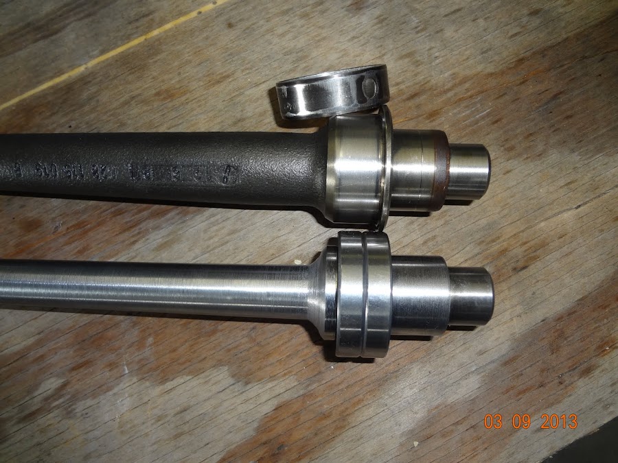

I agree, a toothed belt is the lowest HP usage by far. Here's a shot of my IM shaft bearings (two ball bearings stacked)
A Smalley spiral ring holds them in place and I found an oil seal that fit as well. I cross-drilled the oil port which is now blocked off by the bearings. If I had it to do over, I'd have used a slightly smaller drill diameter
I turned down the shaft to lighten the rotating mass ind balance it better.

Wow - talk about nice  :o - double roller bearing conversion for the IM shaft, with a REAL drawing of the part. Very nice.
Was the shaft ground to size, or turned in a lathe?  I manage a small manufacturing company with both shaft grinding and CNC lathe capabilities.  Looking over the horizon, I can definitely see that I might like to "borrow" this design.  REALLY nice work there, Gizmoman!  Do you happen to have the dimensions for the keeper groove?  If not, no big deal, I think I can find recommended dimensions from Smalley.
I don't want to bug you to death with questions, but is that the cross-drilled hole at 10:00-ish position in the upper photo?

Also what advantage do you think you gained by installing ball bearings on the IM shaft? 1/4 of a hp?
