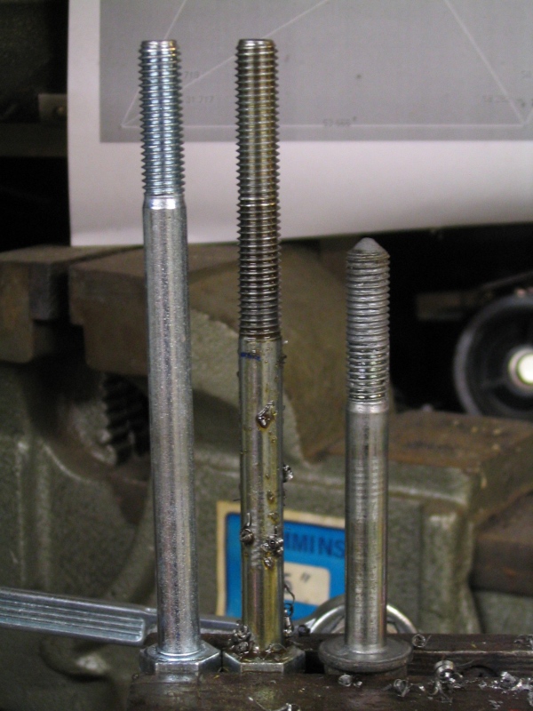

IIRC, it's something like  10 x 1.5 x 110..
The one on the right.
the others are 140mm
I have one somewhere in the shed, but it's raining like hell out there now... tomorrow I can get the length.

All mine are w/AC: 10 x 95 (1.5 pitch)
