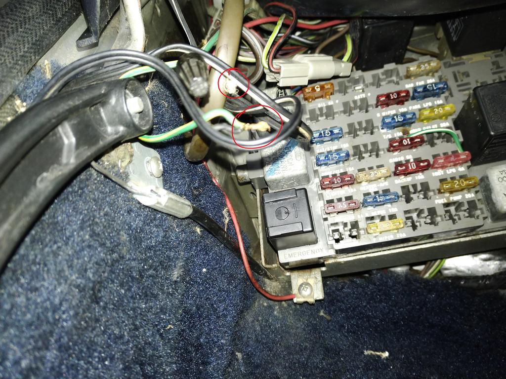

dbird
  • 13
Re: 1981 Rabbit Instrument Panel - Temp gauge/fuel gauge
« Reply #17 on: November 10, 2025, 09:43:05 am »
Here is an image of my fuse panel. I tried some of the fuses that I believe the temp gauge/fuel gauge would be hooked up to, they look good. There is some weird stuff going on around it though, not really sure.

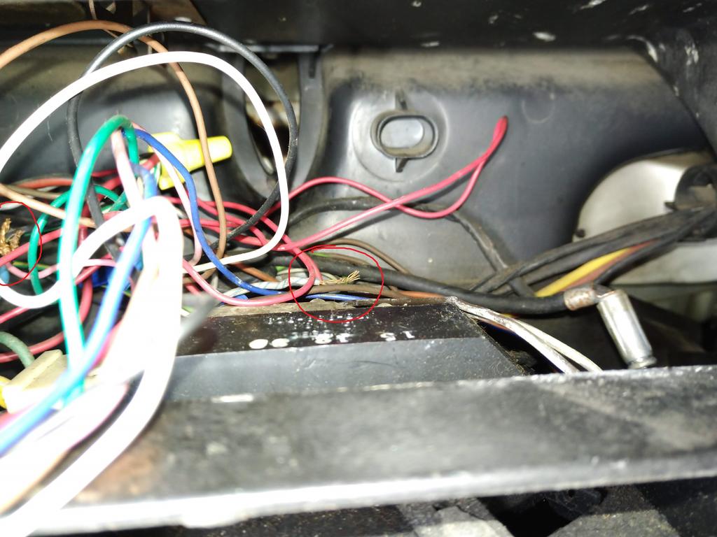

Here is a picture of the inside of the dash (where the radio would be): There's a white wire with blue stripes that is completely disconnected.
This is looking inside from the radio hole, pretty much looking forward towards the front.

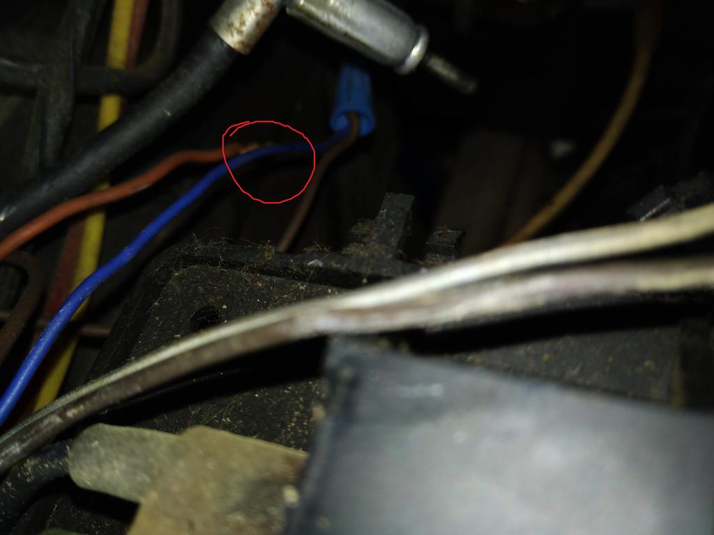

And here is another picture of a wire that is disconnected. This is looking down from the hole where the radio would be, looking towards the passenger side of the car.

Reply #18November 10, 2025, 05:11:34 pm
fatmobile
  • 2931
« Reply #18 on: November 10, 2025, 05:11:34 pm »
 The brown wires are ground wires unless previous owner added them.
Like the bottom pic where a blue wire is twisted to the brown wire bundle.
I can't think right off what the green/yellow wire in the first pic is for.
Looks like the previous owner liked to strip the wires and use the twist connectors.
 So the stripped wires might go to the twist connector nearby.
