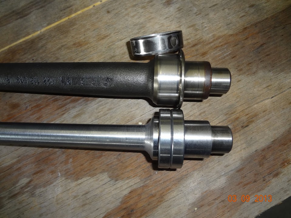

I have a few things that may be causing the low idle pressure like a "custom" ball bearing IM shaft. The outer races of the dual ball bearings blocked the original oil port (to the stock sleeve bearing) so I cross-drilled it to flow oil into the front side of the bearings behind the seal/cover -- should have used a much smaller diameter drill bit.
