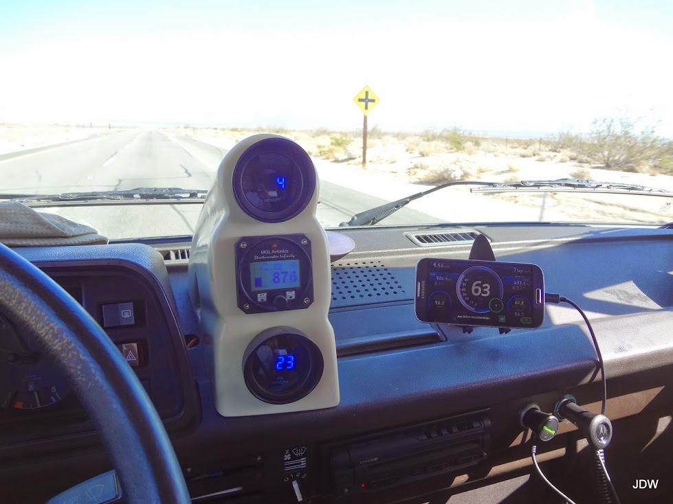

I do run low boost - just not often. Here is a shot running along the 395 North. Flat with a very slight tailwind. . .
63 MPH, 4 psi, 876 EGT, Oil pressure 23 (the OP is not correct - actual is closer to 33 psi - new gauge on order)
