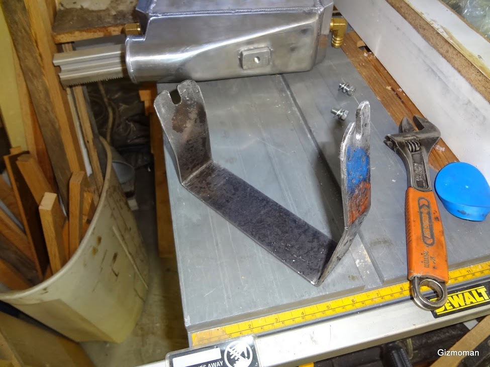

Here is the 10 gauge WAIC bracket. Still needs mounting holes and a good coat of paint.
The assembly (upside down)
In position
 The plan is to do another silicone 90 and a very short straight to the left port of the cooler. The right cooler port will 90 into the intake I still have to build. About as short as it can get without doing the "direct intake mount" mentioned earlier.
Oh well, there goes another weekend. At least I have a turbo drain that will actually drain ;D
