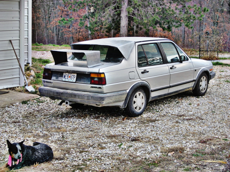

Here is mine.
I am not totally happy with the aesthetics of the deck lid parkbench. I did some tuft testing and can get air flowing over the top of the tail fairing.
Part of my design is to keep access to the trunk without hassle.

Honda-itis.  is that for real?
Reply #12December 08, 2012, 11:18:39 pm

I take it you've never looked at eco-modder Coaster?

« Reply #13 on: December 09, 2012, 06:26:46 am »

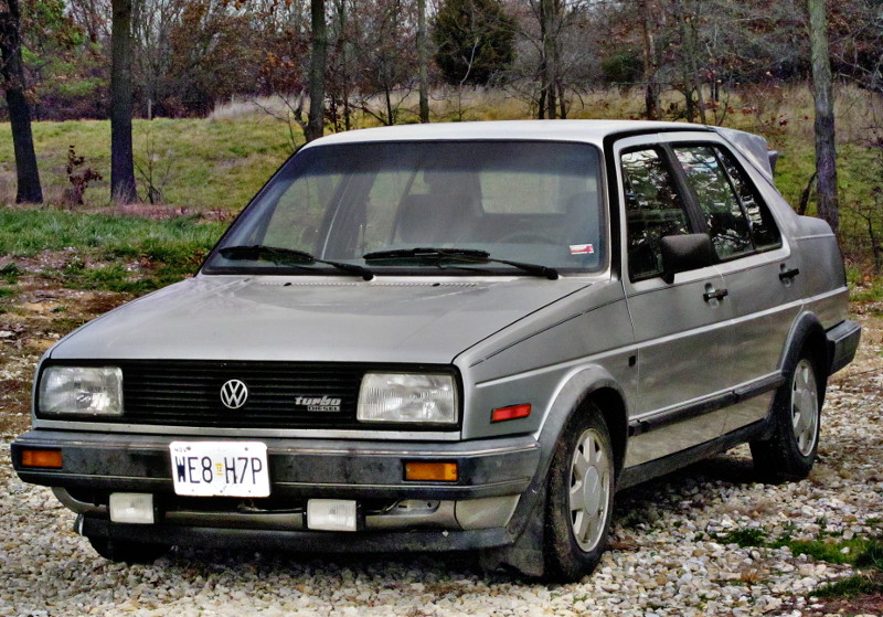

Ricer, ah yeah .... It's the 155/80 snow tires running 50psi  and stock exhaust that give it away. :)
A previous owner did put koni struts and springs in the car.
Nothing wrong with good mileage. Less wear and tear. Less air drag.

The shell looks like it's in good shape. ::envy::
55mpg is pretty damn good, my 86 has gotten close... maybe this year, after a swap.
