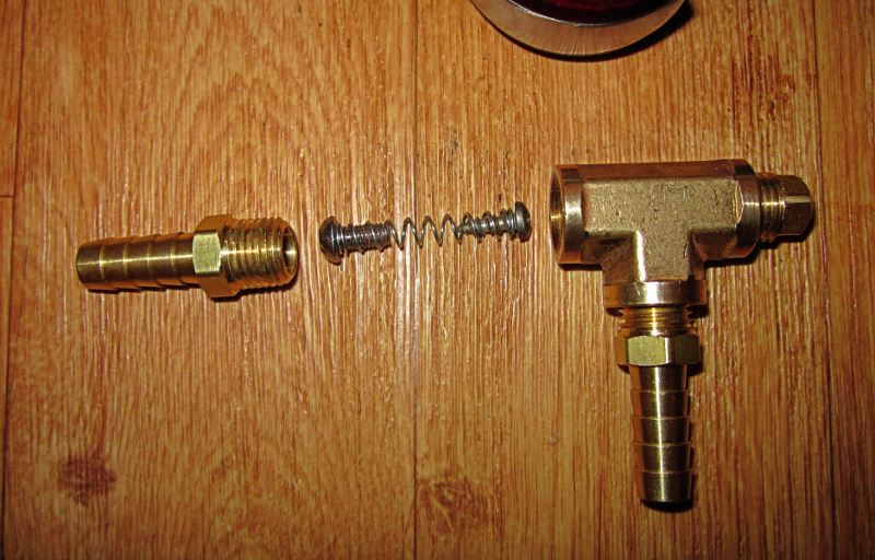

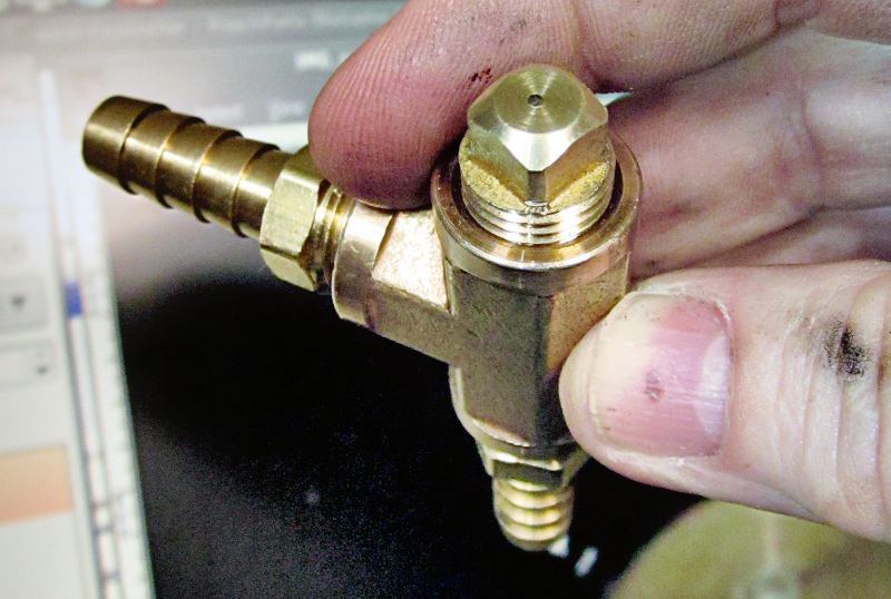

I have to re-engineer the brass T fitting to accept the metal lines. Anyone have pictures of their mbc.
My engine revs just like a gas one. My MB turns up like my tractor almost. It does put out the boost with a very quiet sound.
M2 Jetta TD. Northern Missouri
Reply #14
December 03, 2012, 05:12:19 pm
5104
Re: How much boost pressure should my 1.6 TD have?
Reply #14 on:
December 03, 2012, 05:12:19 pm »
Metal lines so u have a k24. You can just cut the metal lines and slide rubber hose over them, put a zip tie around them to help keep things from popping apart. K24s spool up pretty nice, they're not an instant shot but once u put a mbc on and increase fuel it won't disappoint
