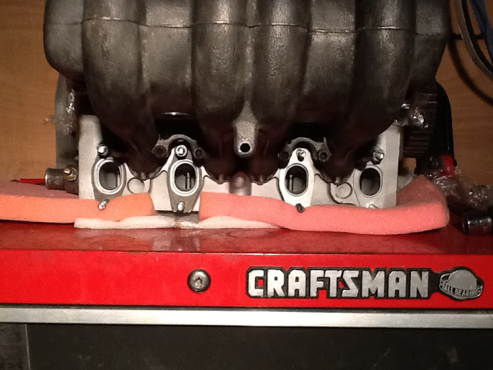

I have the exhaust manifold gaskets that are fiber on one side and metal on the other.  I am aware that due to the geometry of everything that the gaskets only fit one way.  However, is this correct?     (The left two have the metal side toward the head,  the right two have the metal side toward the manifold.)  Or did they send me two wrong ones?

The manifold gasket thing is a known source confusion, and it doesn't seem to make sense but that's the part.

the gaskets r ok..thats the way they are..
