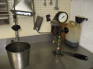

You need one of these, or some variant, to rebuild injectors:
 If you're only doing one set of four, you'll be ahead of the game to buy a rebuilt set. My experience is that Bosch rebuilts need to be rebuilt out of the box. Best to send your used injectors to a legit diesel shop and have them done by someone who cares.
