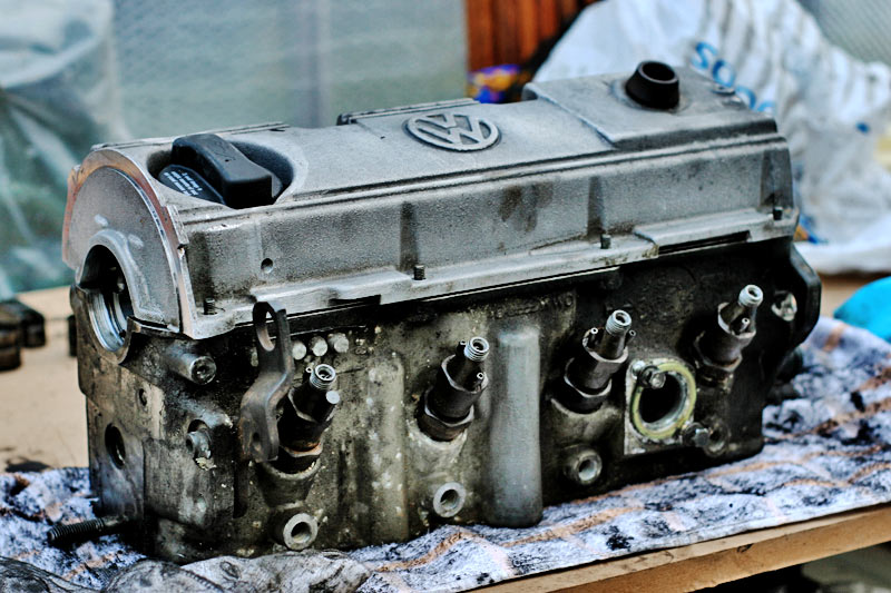

heres a quick test fit i did at the weekend (before i began to clean the head)
looks like i'm gonna have to sort out a new cambelt cover, and shoulderless bolts too... would you consider posting one of those rocker cover gaskets n bolts to the UK?
would be v interested to know, as then i can justify having the cover painted up
