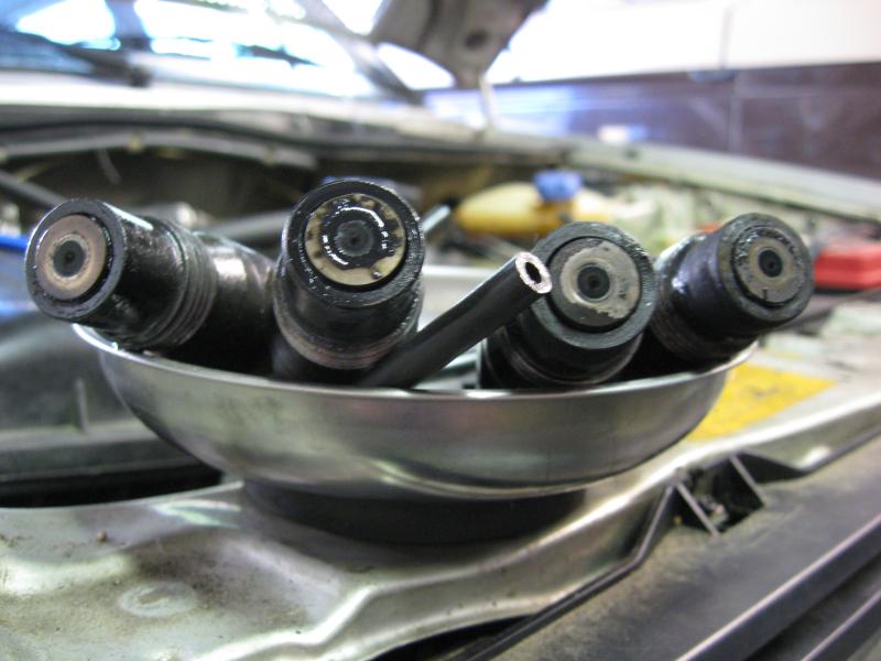

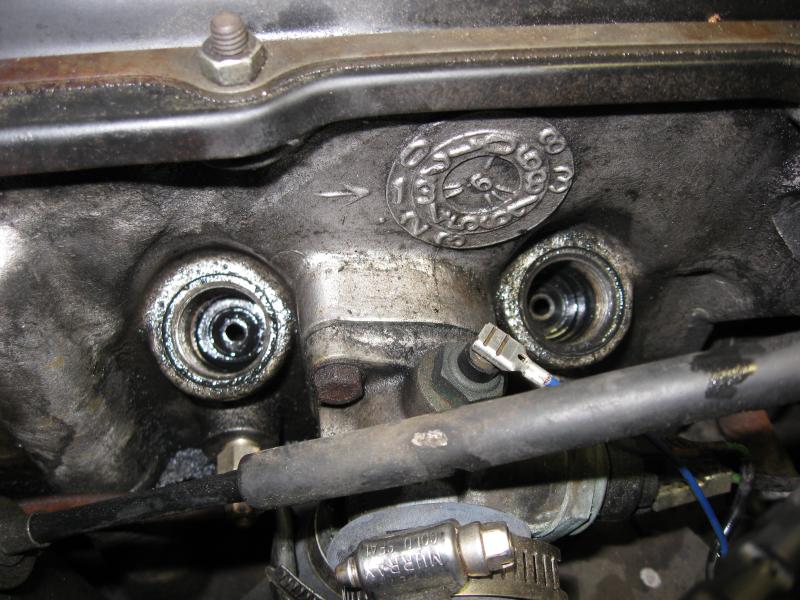

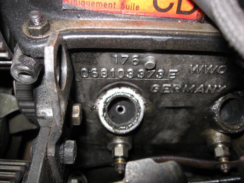

I noticed that the two injectors closest to the timing belt had a ton of carbon built up both on the injector and in and around the heatshield. So much so that I could not remove the old heatshields & reused them after cleaning up in there. The two injectors on the opposite side had little/no carbon buildup and were very wet.
(these are backwards - furthest right injector came out closest to timing belt)
Carbon build up
No carbon build up

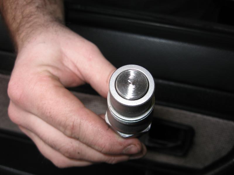

Oooh shiney!
New injectors are the cleanest thing on this thing!

I wouldn't think of reusing those heatshields: http://www.vwdiesel.net/forum/index.php?topic=22292.0
One way of getting 'em out is to pull the injectors and crank the engine over using the starter, they should blow out, if that don't work try a slide hammer or large screw screwed into the hole in the shield. I can't remember what it looks like on the other side of the heatshield so I don't know how easy it would be to bugger the head by stickin' stuff in there.

Then pull it out with a large screw screwed into the center.
This is the key trick... a big wood screw works well so that the threads seat into the hole well.
You may mangle the heatshield a bit but it will come out.  ;)

I like using a long tapered punch. Lightly hammer it in there and then just wiggle it around. That will usually break it loose.
