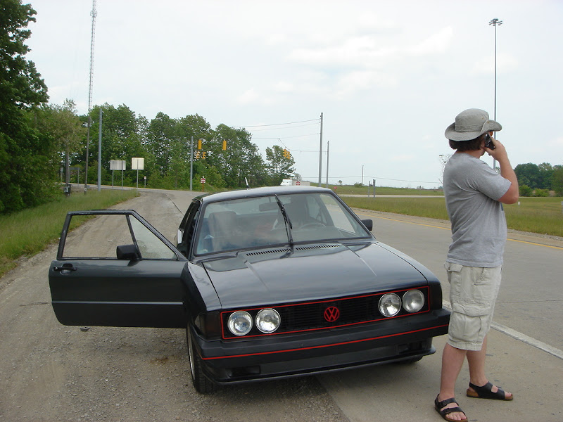

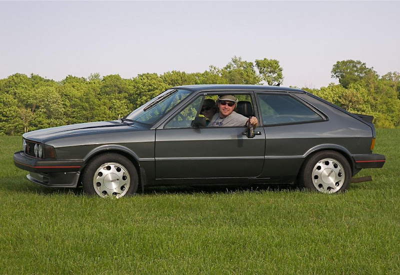

Wow, that was a blast from the past.  :D
Well, the '84 is gone.  Here's what I got now:
And here is how it sits right now:
It will in fact be a M-TDI swap.  I have the engine, just waiting on funds.  My Wife's Golf is getting finished first.  :D

Nice. That's a clean looking car
