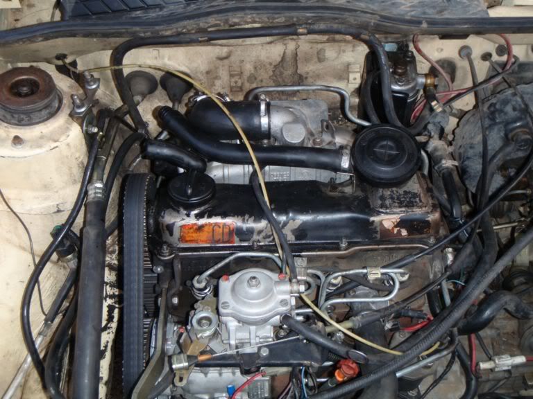

well i had time to get a couple photo shots out so here is my car. will be sure to post many more in the general section soon. I will keep this thread to relevant pics if some are needed later to figure out my wire issues
