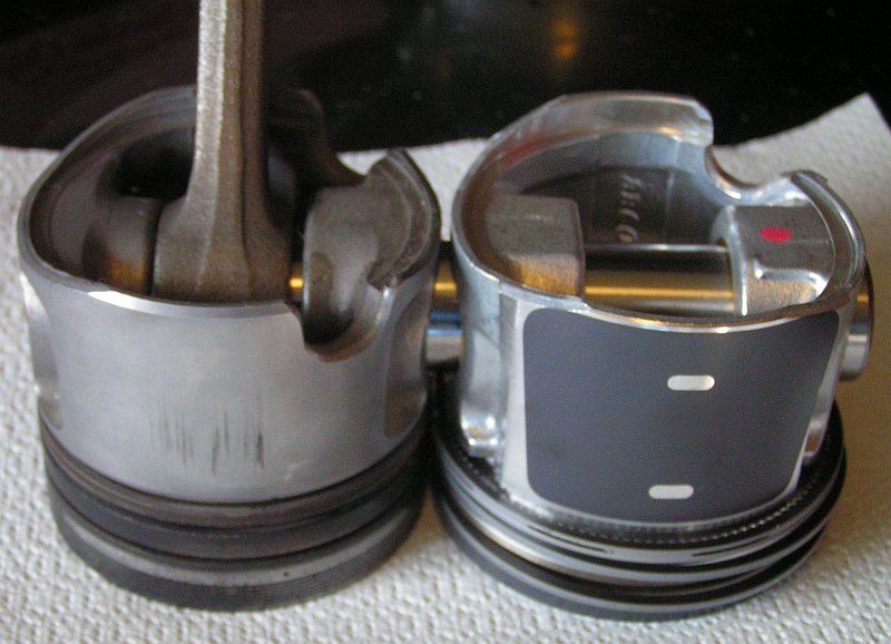

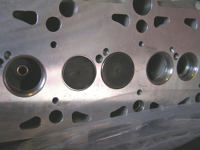

TDI vs AAZ pistons-identical dimensionally!!! YAY!!!

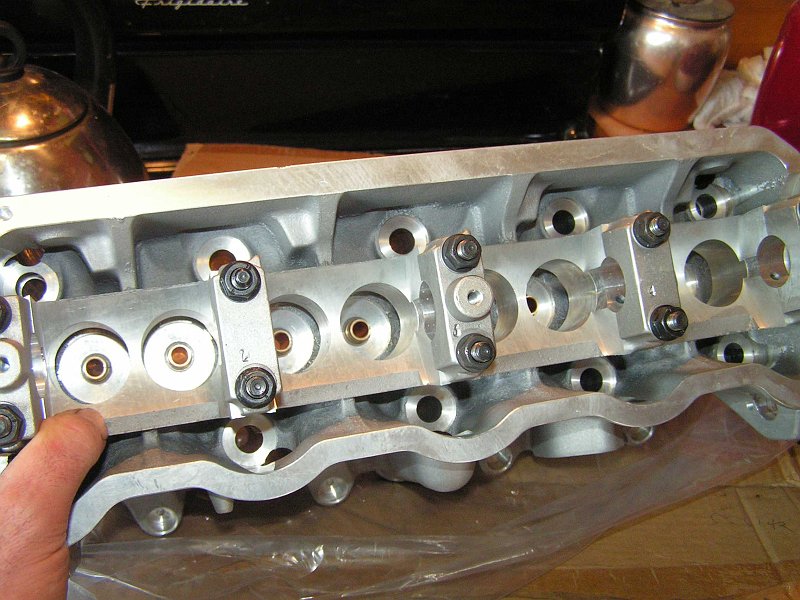

Emiata.com head from injector side.
Looking down from the top.
Looking at the runners. They are a bit rough by the valves, but not too bad by the manifolds. The stock VW head is smoother by the valves, but I wasn't expecting too much for the price.
And now for the best parts!!
The AAZ valves are a perfect fit in the 1Z head!!!

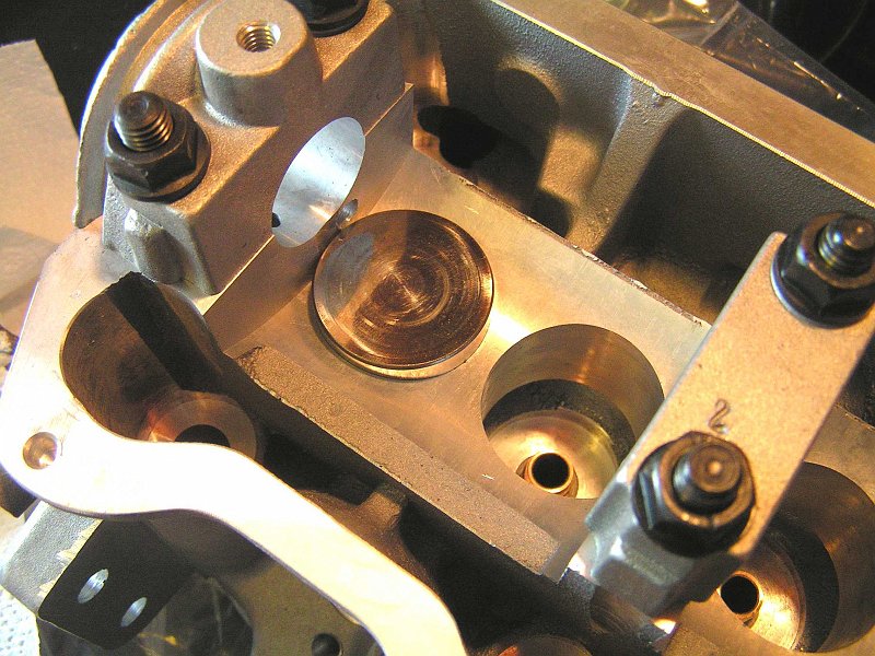

The AAZ lifters are also a perfect fit!!!

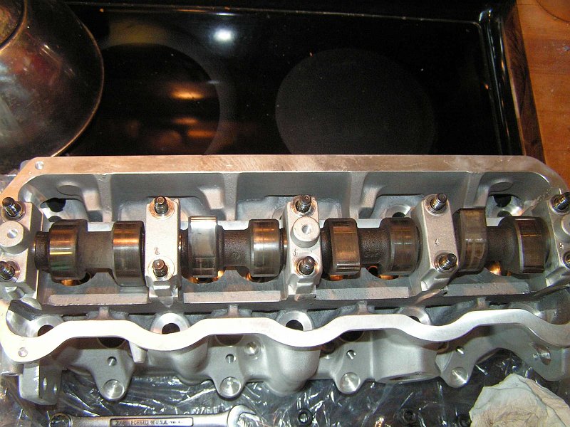

And the AAZ cam is a fit!!! This brings my head cost down considerably as I had thought I would have to buy new everything for the head.
My new 10mm TDI head.  M-TDI here I come!!!! :twisted:  :twisted:  :twisted:  :twisted:  :twisted:  :twisted:  :twisted:  :twisted:  :twisted:  :twisted:
