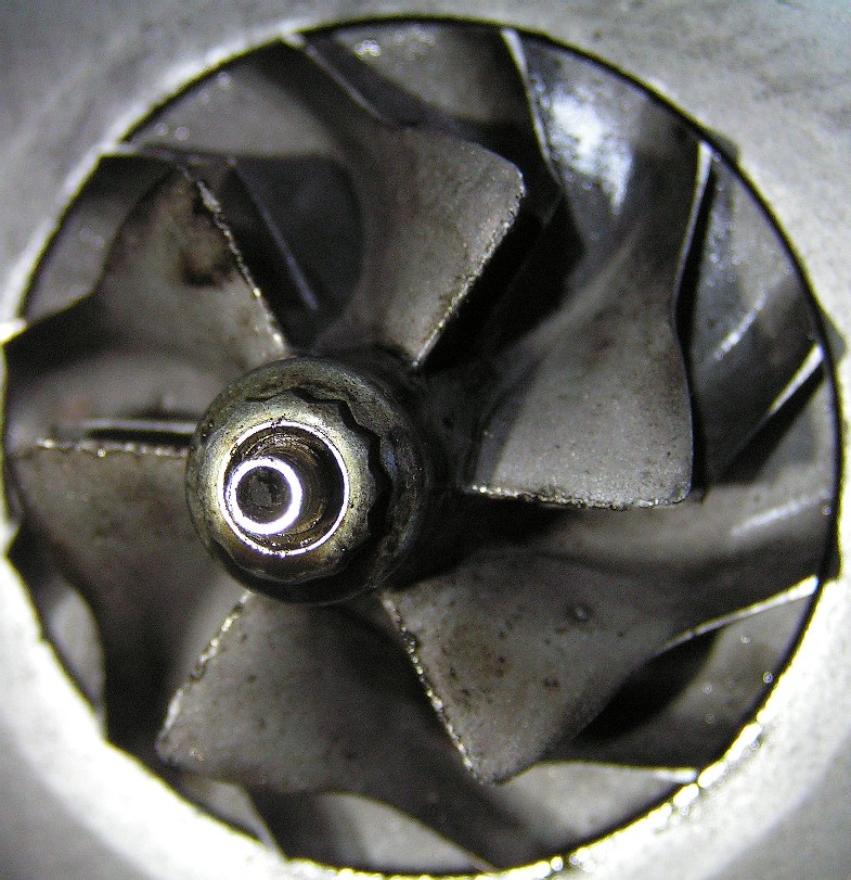

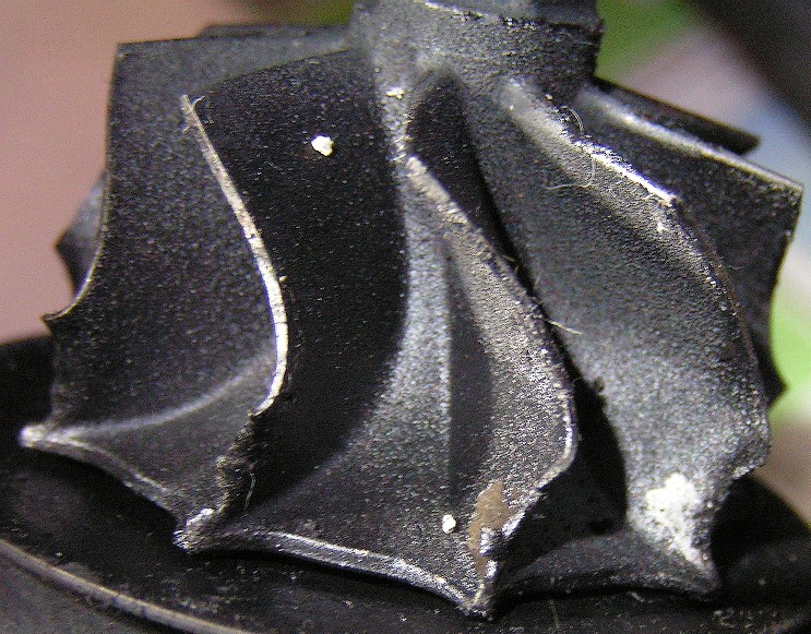

I finally got around to taking the turbo apart today. While the compressor had been rubbing a little, it isn't as bad as I feared, so I may try to reuse it. The turbine wheel however has taken a beating, probably from piston parts going through it, the vanes are also bent, so I will have to find a way to fix it. I still have a good VNT-15 compressor and scroll and a good GT2552V compressor and scroll, but no good exhaust sides. I do have an extra set of vanes for the VNT-15, so that will be the easiest part of the exhaust to fix.

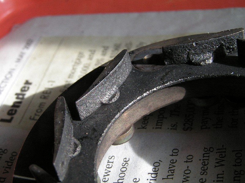

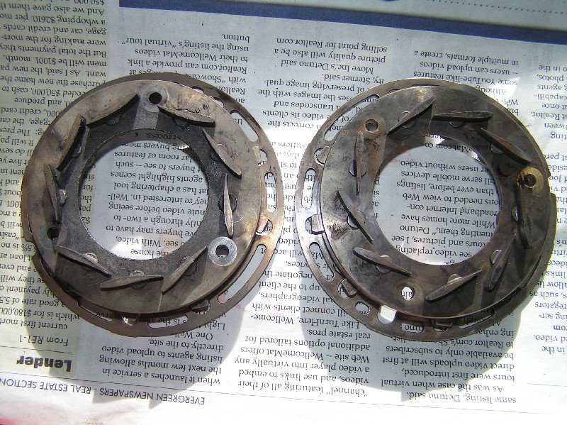

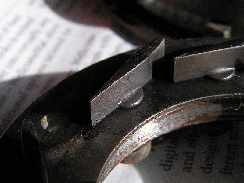

More turbo pics.
What the vanes should look like, straight and smooth.
What the vanes looked like, bent and pitted, maybe melted a bit. I'm not positive as I'm sure piston pieces hit them, but I would think the steel would need to be soft for hot aluminum to do this to them. After my engine was dieing, my EGT's were easily getting to 1500F with just moderate throttle so I would bet more on heat being the cause. I would say keep your VNT below 1350 to be on the safe side.

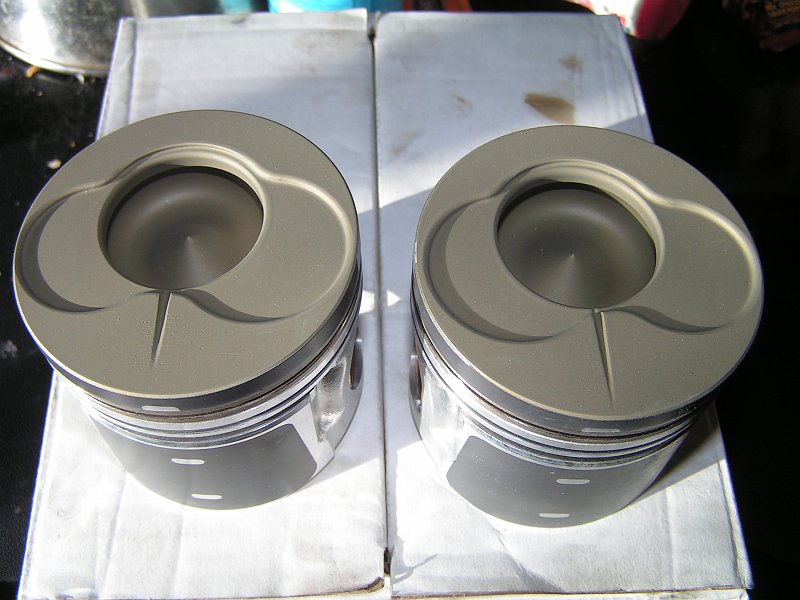

Today I brought the crank timing gear down so the crank can be ground. I also brought the head down as they had forgotten to put a smoother surface on it. It should probably be done by Friday or Monday. The pistons I picked up and brought to get ceramic coated. They won't be done until late next week or the week after as his ceramic was getting a little thick so he wanted to order some new stuff. So nothing new as far as pictures go.

I got my pistons back from getting ceramic coated. YAY!!! I also got the block and head back. They weren't done with the crank mod for the TDI pulley however, BOOO!!! It is supposed to be done today however. Then the important question can be answered once and for all, are the pistons too tall. I am pretty much positive the answer is no, or I wouldn't have gone to this much trouble.
