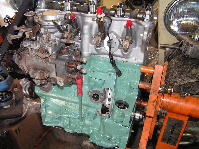

It looks like I will be getting some work done today as I think I have all the parts I need now. I got my new crank bolt and got my new nozzles as I had at least one bad one, and one injector put together wrong so that it had no pressure. Oops, I think it was the very first one I took apart, the different #3 injector. I thought I put it together the way it was, so maybe it was wrong to begin with. I will take them down to get tested, then some serious assembly will begin. Hopefully I will get it started today to make sure I didn't screw the pump up too badly. If I did, I may put it back together as an AAZ pump, then when I get the money, buy a core and have Giles work on it. My stocks are going back up quite a lot, so I may have more $ in the future for such things.

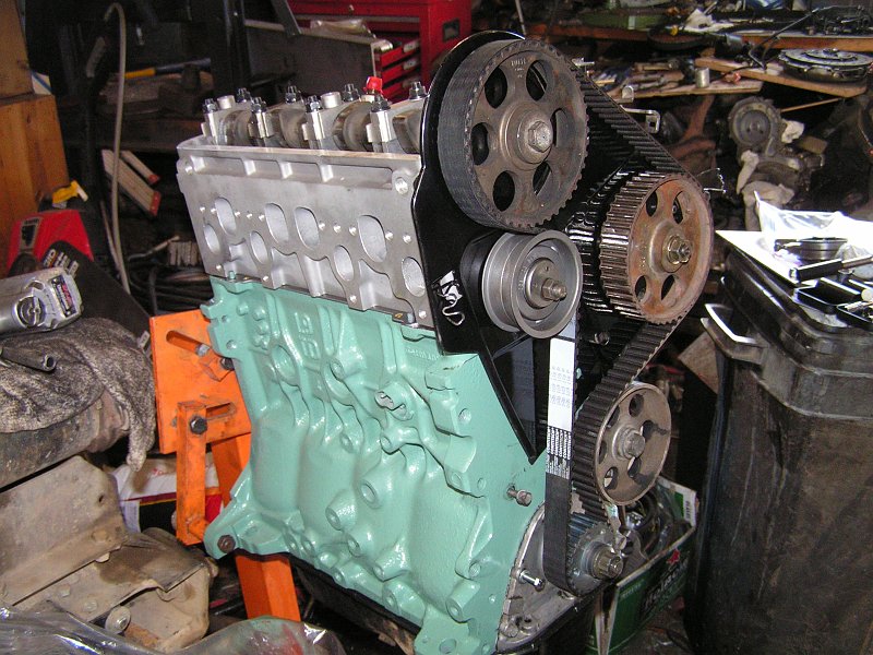

Got the timing belt on.

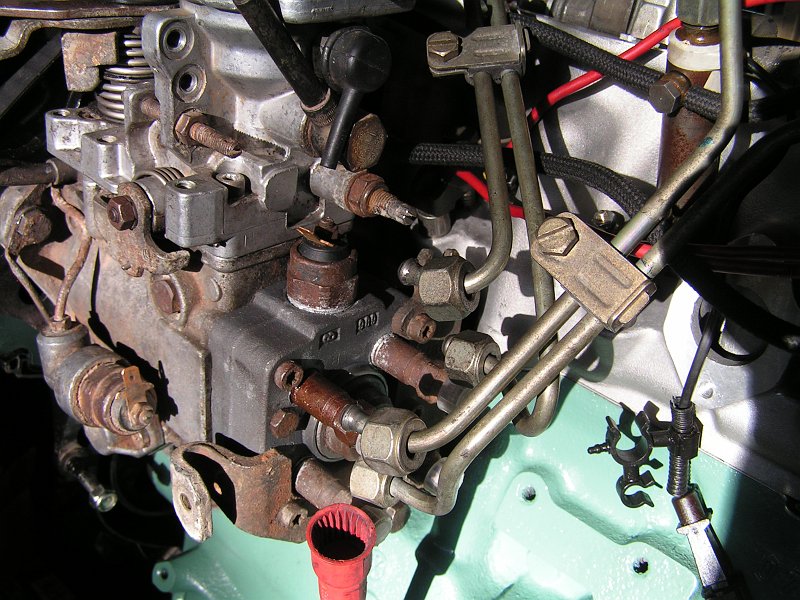

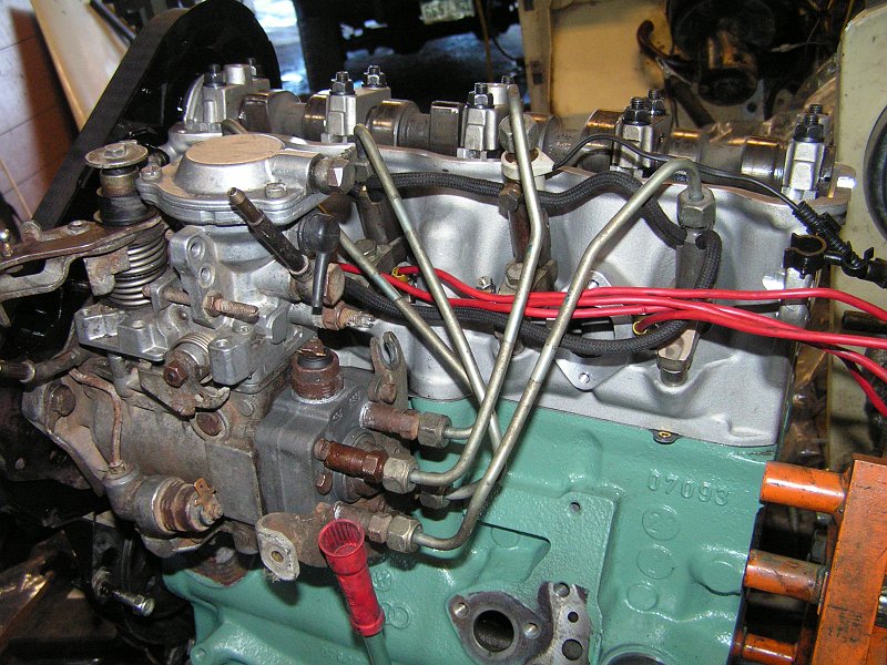

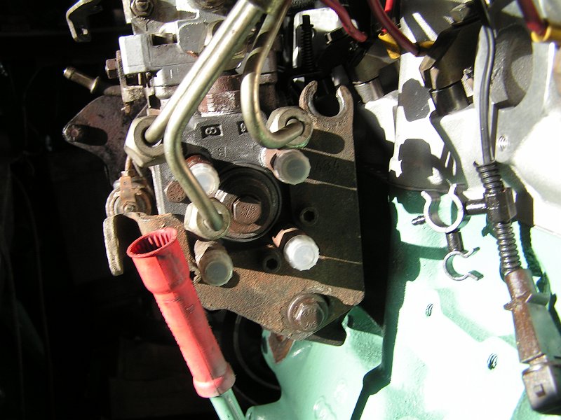

Things don't line up right using ALH lines.
From the back.
After lots of creative bending, everything plumbs up.
One other problem I had was timing the pump. For some reason I just can't figure out, I had to jump a tooth on the IP sprocket. So now my pump lock pin is no good when everything else is at TDC. I'm wondering if it might be from the TDI sprocket mod on the crankshaft.

You guys are asleep, like I must have been. I'm surprised no one said anything about my tensioner being turned the wrong way. Luckily that.s what sleep is for, so your subconscious to tell the rest of your brain that you screwed up before it's too late.  :lol:  :lol:  :lol:
