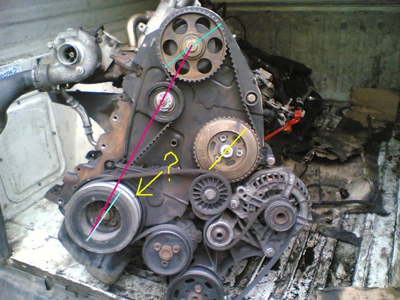

well - I took these on the way out to work this morning. I see the mark on the cam pulley - I'm not seeing a place to put a 6mm pin on the pump pulley - I'm going to go search some more, but I'm missing the obvious please tell me
In your full front pic of the engine the pin fits in the pump pulley hub at the little slot at about the 2 o'clock position. The pump will need to be turned a bit more clockwise before the pin will go into the hole in the pump housing, the hole is obscured by the pulley hub in the picture. I have an edited photo but its on imagestation (may or may not work...), my favorite "uploadpixels" appears to have been hacked by some crazy turks...
Anyway, the big red arrow marks the spot that the pin fits through the hub.

hmmm - knowing that, and looking at the pic, it seems likely the motor pic was taken just as the tech was finished with it.
SO - who knows about the markings? Looks like both the indicator on the crank is "down" as well as the mark on the cam - I think(might be pointed UP actually) - is that as it should be when setting timing? I have the original he sent me, somewhere, prehaps the cam mark shows up better there.

the higher res pic says to me things could be off - and explain why the engine runs so bad.
a.jpg)
link to the high res copy, un-paint-chopped
http://www.supermotors.net/vehicles/registry/media/317496_1again - I don't know where the marks are supposed to end up, but I will get them lined up this evening and see where it's at.

The mark on the balancer is a balance hole not a timing mark. There aren't any timing marks on the balancer of any VW engine I've ever encountered. The marks on the cam sprocket are also meaningless as it has no key and can be installed in any orientation. The cam must be locked at the rear with the cam locking bar.
You might have trouble getting the pump timing pin installed since the TDI rear cover from that era does not provide access to the front of the pump housing where the pin bore is located. The TDI did not use the small pin/slotted pulley timing method until the new style ALH engine, so the rear timng belt cover does not provide access. The installer must have done some cutting to get the hub through the cover though, so you migh be alright. The hub cannot be removed from a late model 1.9TD pump, it has no key and the timing is lost if it is removed.

You really have to stop looking at the front of the motor, there ain't no timing marks there. The cam sprocket fits on a taper so it can be installed in any orientation so the marks are useless. You have to pull the valve cover and use the proper setting bar or a suitably thick hunk of metal to set the cam position. And until you properly mark the flywheel, you'll be working blind there as well.
