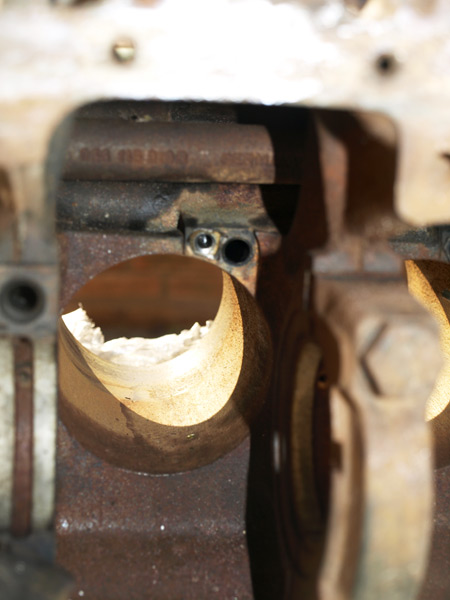

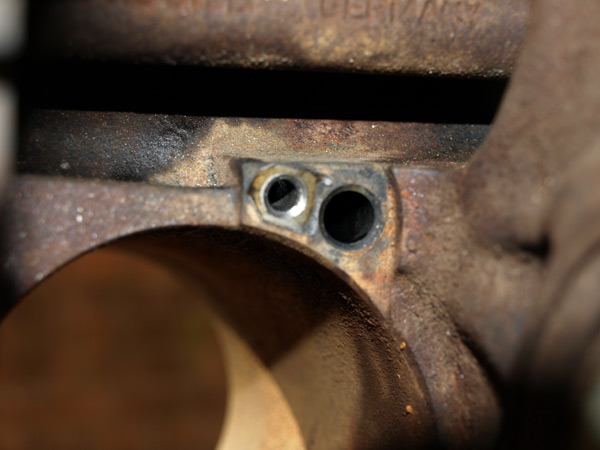

Does anyone know for sure if the oil passages line up the same on the 1.5 block as with the 1.6?  The 1.5 doesn't have the ridges the 1.6 does where the squirters plug in.  I don't want to blindly start drilling holes.
« Last Edit: October 26, 2024, 06:59:51 am by drrtybyl »
'79 Rabbit Diesel L
'94 Chevy 2500 6.5TD
'96 BMW 318ti
Reply #31February 28, 2009, 07:35:28 pm
'79 Rabbit: Another 1.5TD
« Reply #31 on: February 28, 2009, 07:35:28 pm »
unless you are extremely confident of your skills, i wouldnt tackle this job. and i wouldnt do it unless your gonna make tons of power or really high combustion pressures. i ran the snot out of my 1.5 and i never even came close to melting a piston, never had an EGT gauge either. just had the stock oil cooler on it and it always stayed cool.
Reply #32March 01, 2009, 06:42:34 am
« Reply #32 on: March 01, 2009, 06:42:34 am »
I would assume it is the same, BUT I don't know it. Looks like the same IM shaft location, same trans bolt pattern, and same oil pump parts but I don't know about the oiling. The way VW likes to reuse everything in the design makes me think they wouldn't change it. I would say go for it and if it were me I would go for it on a rusted cracked junk yard block first if I had the option. Or ask someone on the forum that has a junk one they could drill really quickly for you.

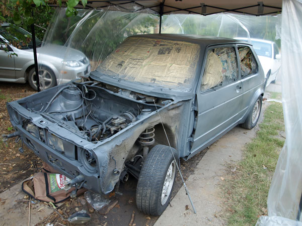

« Reply #33 on: May 04, 2009, 08:13:09 pm »

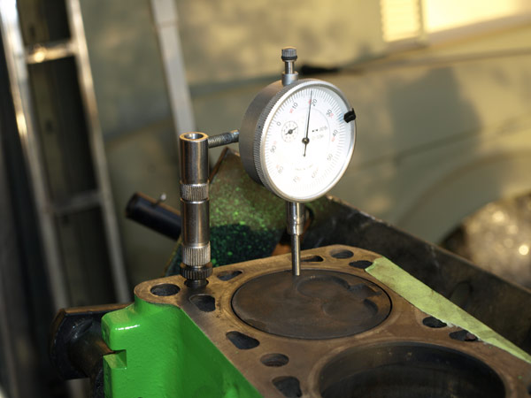

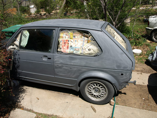

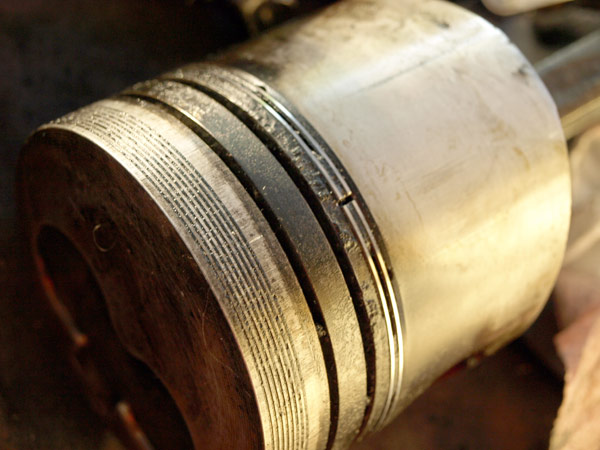

It's kind of hard to tell in this picture, but when pulling and re-ringing pistons I discovered that the oil ring in #4 wasn't expanding at all: it was being held shut by all the carbon and other crap lining the piston..
Apparently all of those extra pieces you get in the super-low budget pump timing kit are good for something

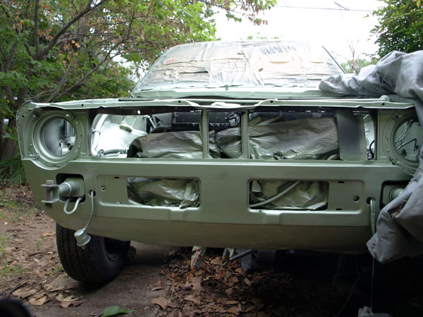

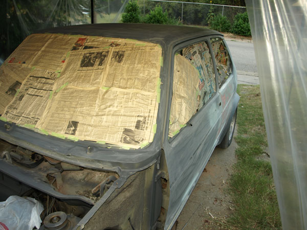

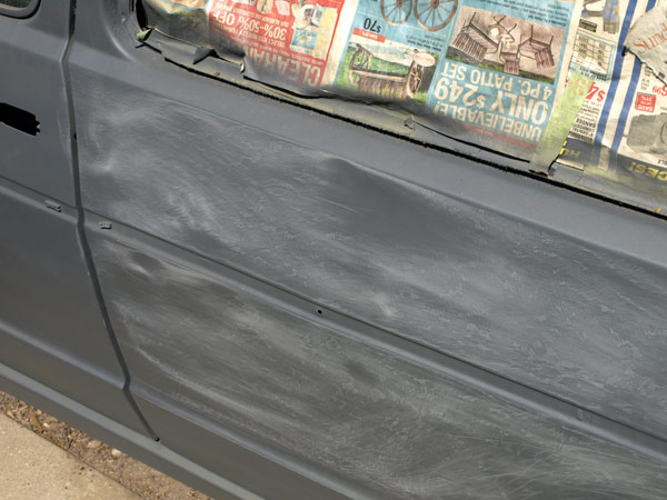

First coat of outer primer
Tons of dents (pre-popping)
This area has been tons of sanding/filler work to flatten even with most of the pitting pulled and hammered out.
The body is almost completely smooth and ready for basecoat at this point...
My 1.5 is now ready to go.  Just need to finish the body and drop the engine in.

rotate it over just a box hair to touch the deck to achieve zero. then rotate it a box hair back on to the piston. or is my thinking wrong?
Reply #35May 04, 2009, 08:40:49 pm
« Reply #35 on: May 04, 2009, 08:40:49 pm »
i actually considered that, but wasnt for sure if everything was threaded. so, yea, it wouldnt give an accurate reading..
Reply #36May 04, 2009, 08:43:27 pm
drrtybyl
  • 146
« Reply #36 on: May 04, 2009, 08:43:27 pm »
Deck was set horizontal with a level; dial reset with straight edge held across the deck/piston..  The assembly there is very rigid.  Got the same protrusion measurements for 1/4 and 2/3 with multiple checks.
'79 Rabbit Diesel L
'96 BMW 318ti
Reply #37May 04, 2009, 08:45:07 pm
« Reply #37 on: May 04, 2009, 08:45:07 pm »
Quote from: "libbybapa"
I suppose you could place a piece of fairly sturdy piece of flat across the cylinder with the piston below it.  Then measure to the top of the piece of flat and zero the gauge.  Then bring the piston up.
you know what, i had that exact idea right after i did my last post, but i was just too damn lazy to edit my post. lol

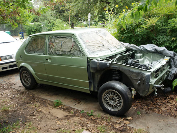

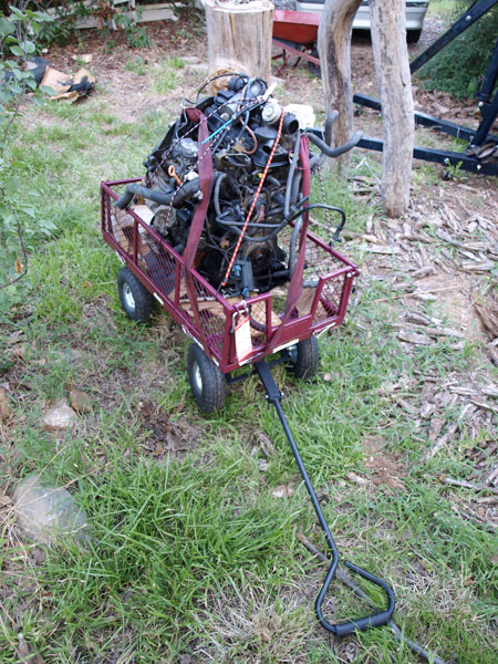

The car is finally prepped for sealer, base and clear coat.  I've been dropping in on yards for the past few months trying to find turbo parts without much luck.  Yesterday I came across an amazing deal on a complete TDI from a wreck including harness, cluster etc. which I pulled and am now planning to install instead..  It's funny how the DME is located in the rain tray area right under the wipers -- just asking to be destroyed.

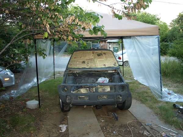

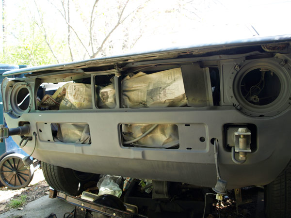

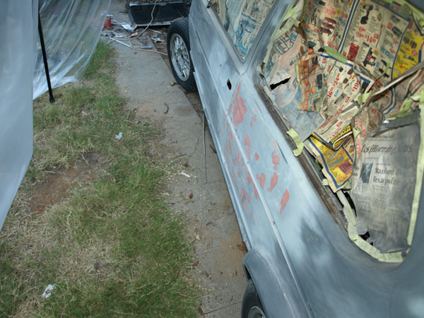

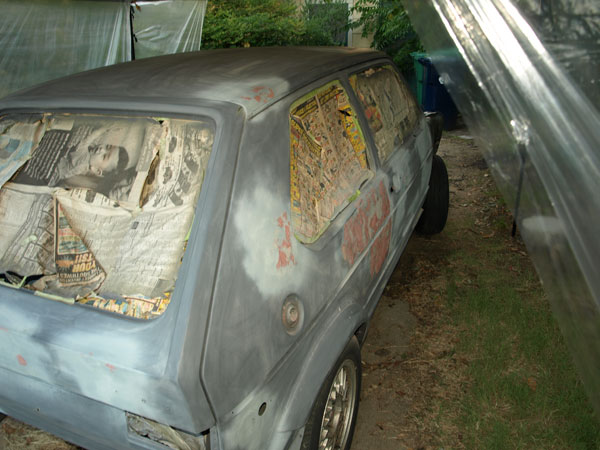

Painting..
« Reply #39 on: July 20, 2009, 08:22:21 am »

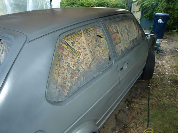

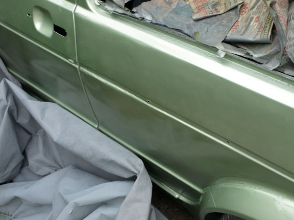

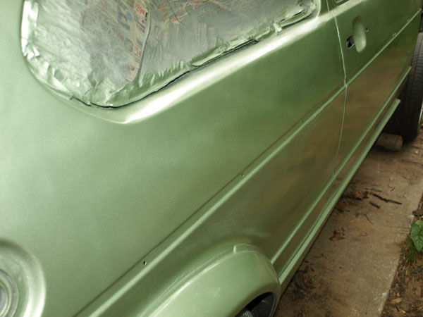

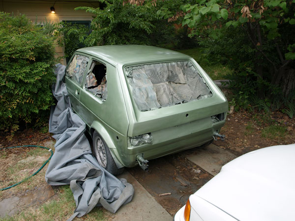

Put down final primer, sealer, base, and 2 coats of clear.  The color seems much greener over larger areas than I imagined it would be.  Going to put down 2 more coats of clear and then wet sand even.
scuffed and clean:
sealed:
painted!
Now to do the doors, hood, and sort out the TDI.  Does anyone have a wiring diagram for a 98 Jetta TDI?  ;D

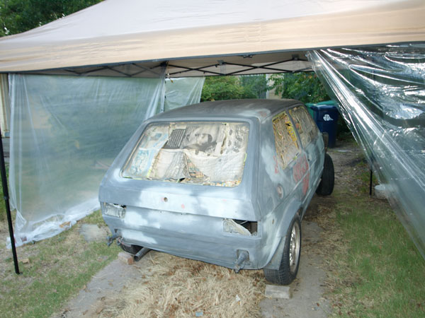

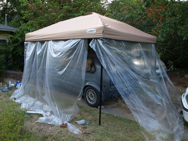

Outdoor paint booth, I like it!  :)
Build is looking good!
Reply #43July 21, 2009, 09:38:09 pm
Rabbit TD
  • 840
Re: '79 Rabbit: Another 1.5TD
« Reply #43 on: July 21, 2009, 09:38:09 pm »
Yes I like that paint booth too and you can get those canopy thiings pretty cheap now days and use it as a car cover too, until it blows away ;D

Thanks for the encouragement Lord_V.  I'm really having to move with this as it had transitioned into the -getting yelled at- phase.  That's mostly gone away now that some paint is down.
