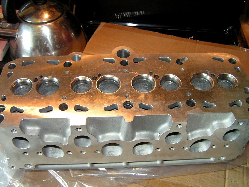

on a mechanical engine there is one main oil return galley between number 2 and 3 injectors on the head. Hydraulic engines have an extra, smaller oil return between number 1 and 2 injectors.
December 31, 2007, 05:07:31 pm
2110
Head gasket choice
December 31, 2007, 05:07:31 pm »
See the big bump on the side of the head left of center, and the associated big round hole on the bottom? That is an oil return not found on a mech head. It will look the same even though the pic is a TDI head.
