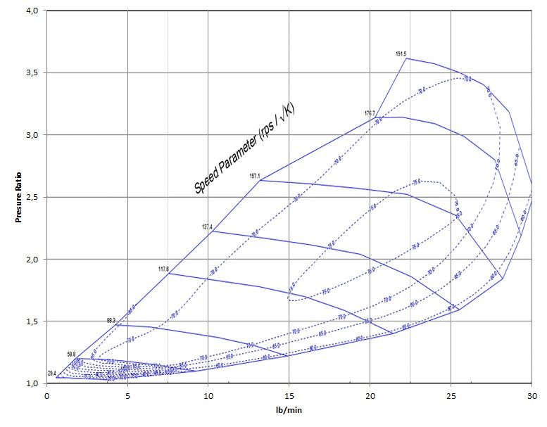

I've measured the wheels with a digital vernier myself, so numbers are not 100% accurate:
Compressor:
Exducer 56,0mm
Inducer 40,6mm
Trim 0.53
Turbine:
Inducer 46.6mm
Exducer 41.3mm
Trim 0.79
And a compressor map off course ;) I converted the mass axis to the more common lb/min:
Pretty close to surge on a stock 1.6TD head, but easily solved by slacking off the preload on the wastegate somewhat (1 round on the adjusting nut). On the 1.9D/TD heads there is no sign of surge what so ever.

very good! where do you get these maps haha?  It is interesting this turbo is similar in size to the gt2056/gt2256 alot of people are running

Hi,
if you have the map also available with "kg/s" axis i would be very glad if you could post that also.
