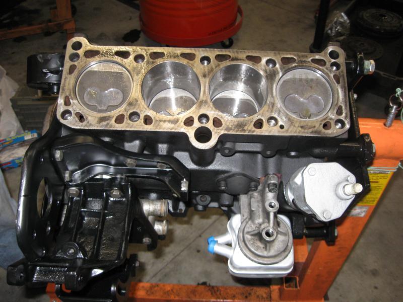

Well got a lot more done this weekend.
Got the ARP rod bolts pressed in and was able to finish installing the pistons. We noticed a small mark on cylinder 4's bore, but decided that it was not deep enough to be an issue and continued on with installation. It looks deeper in the photo but is not deep enough to catch with a fingernail.
Started installing accessories. Water pump and AC bracket installed, along with IP/motor mount bracket. Got the timing sprocket and v-belt pulley installed. Intermediate shaft seal and pulley installed. Put the oil cooler flange and new oil cooler on, as well as installed the vacuum pump.
Ended up ordering a new oil pump just to be safe.
Measured piston protrusion and selected a one notch headgasket. More progress soon!

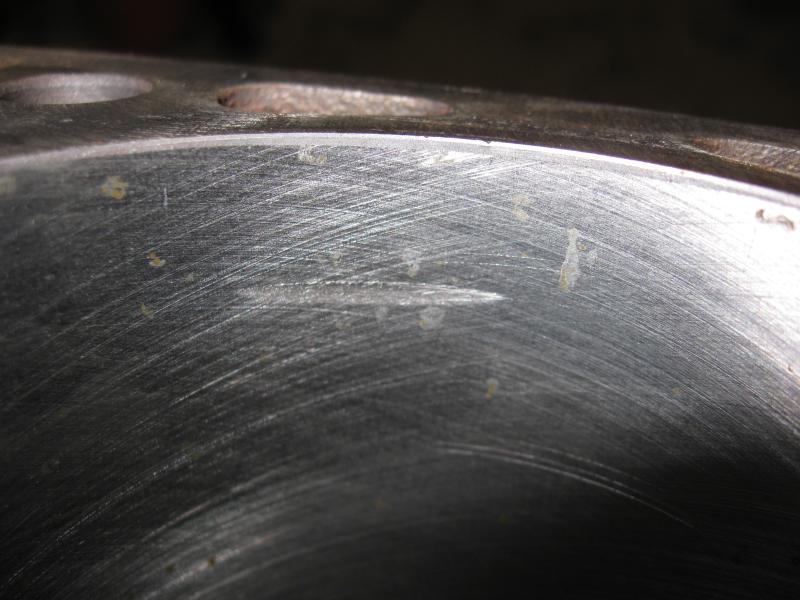

Realized that I never posted pictures of the head after we got it back. Was very happy with the headwork. George was able to TIG the areas between valves, looks great.
Got some more good progress in. Got the intake and exhaust manifolds installed onto the head:
And got ready to install the turbo:
Ran into a small issue. Turbo flange wasn't sitting flat against the exhaust manifold. Found a high spot and was able to smooth it down. It was at a corner, looked like it got bumped in shipping or something and deformed slightly.
Drain too
