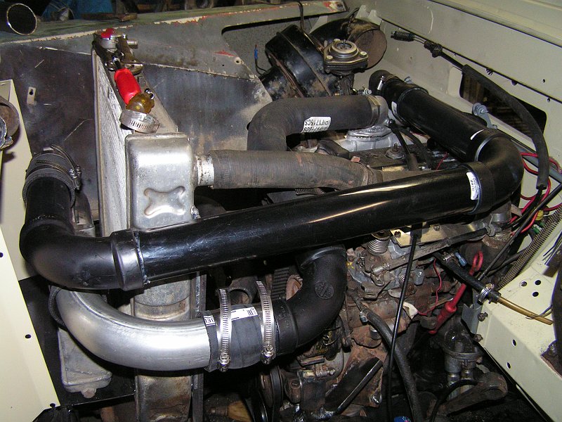

I may run the fan all the time as it is a small one. After a waste of a day trying to plumb the air & IC, I got smart and bought ABS to design a prototype so I could easily change things before spending money on the good stuff. I also got an idler pulley mounted so I can run the h2o pump by itself off the crank.

Thanks for the tip on ABS, I definitly would have overlooked that option

Now what I think would be cool is all lexan tubing. Too bad they don't make it in 90's. Although I'm sure metal would help take a lot more heat out. Lexan takes close to 500 degrees F, so wouldn't melt, and it isn't brittle. Guess it wouldn't look good though if your turbo leaks oil.  :lol:
