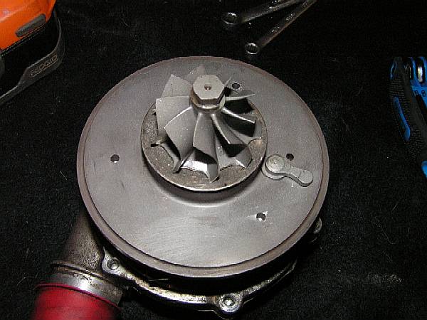

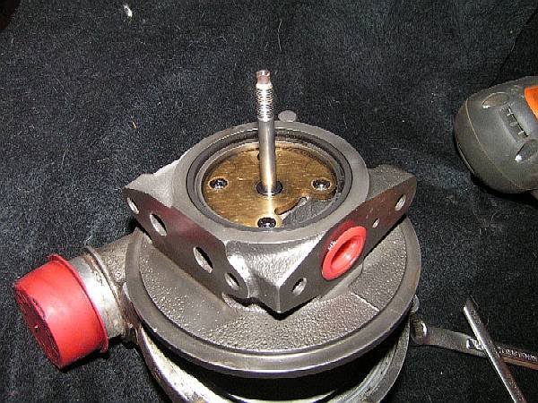

I have a brand new VNT-17 center section. I took the compressor housing and wheel off to put on my 15. The 17 has different oil passages, and also needs water however. I'm not sure what it is worth if it will work for you. I paid $320 including shipping for the whole turbo. I may need the actuator also however, and it takes a different one than the VNT-15. Let me know if you want pics. Actually the passages are just like the one on the GT2559 shown here.

Yes, just fittings, and water cooled. You would just need to put the back plate
for the compressor housing, the compressor, and housing on.

The VNT-15 actuator WILL work. The 17's is different because of the exhaust housing.

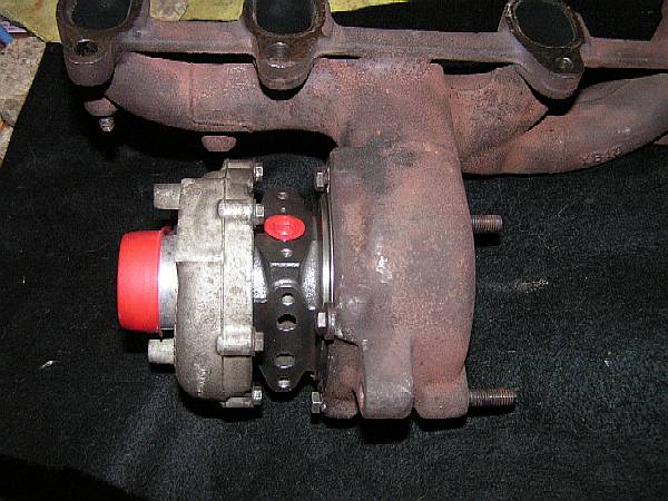

So The first pic is the vnt17 comp, center sec, and turbine in the factory vnt mani/turbine housing?

Ist pic is VNT-15 comp and exhaust housing with VNT-17 center
