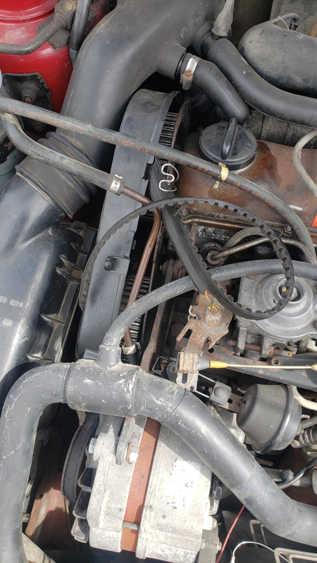

Found a 90 NA 1.6 Jetta in a local-ish yard today! Cant believe my luck...what do you think?
some pics after cleaning, pics in order pots 1 thru 4.
Humbly rolling coal.
90 1.6TD Jetta
79 1.6Na Rabbit
Reply #12May 22, 2022, 10:49:43 pm
fatmobile
  • 2931
Re: 1990 1.6td died while driving
« Reply #12 on: May 22, 2022, 10:49:43 pm »
turbo head.
Those cracks don't look too bad.
 When you pull the cam journals and lifters does the cam teeter/totter in the saddles?
