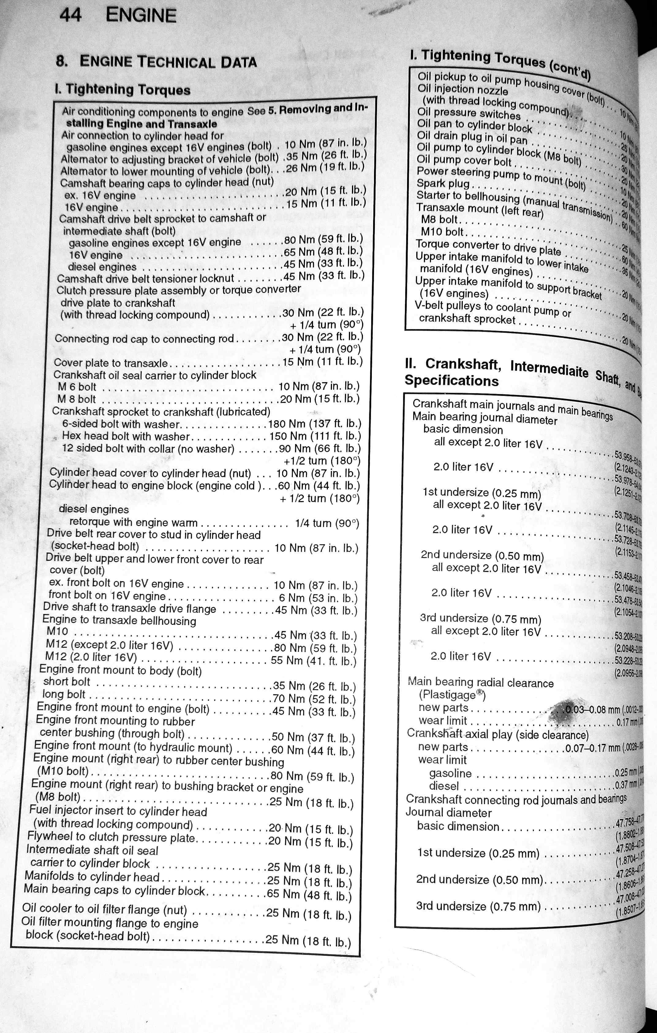

What is the torque for stretch type conrod bolts. The machine shop that rebored the block said it was 30nm + 180 degrees, is this correct. The last rebuild was twenty years ago and I used the original conrod bolts.

This is what my Bentleys says;
I would recommend the book. Mine is stock number vg92

Thanks for the reply Scrounger, Ill go with the Bently 30nm + 90
