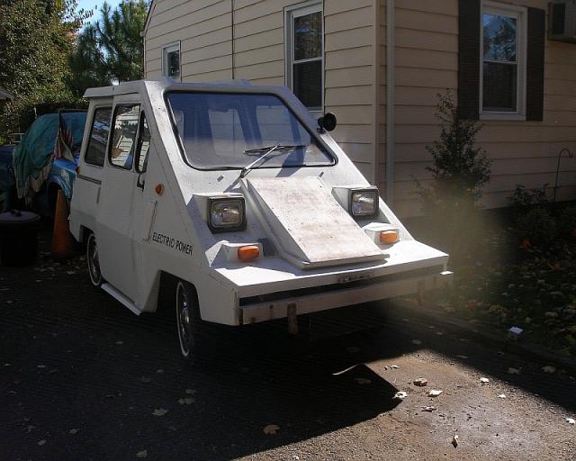

Why would the electric have a 5 speed? Aren't all modern electrics and even hybrids single speed?

It was built in the mid 1970's and they just took out the diesel engine and put in the electric motor.  The Kubvans ran VW front ends and transmissions in addition to an all aluminum box.  You are looking at one of about 50 of them that were ever made.
And now a second thought.  Aren't most of the newer drive trains powered by a single motor but connected to a continuously variable transmission?  So it may appear to be one speed but it is always changing the gear ratios to get faster with the same low RPM of the motor.
Electric motors have sweet spots for power or efficiency.
Even the purpose built electric prototypes for USPS in the Eighties had three speed trannies.
I just looked up the Prius and you are correct. I remember reading about a custom electric using a forklift power train and the owner said he always just used 4th gear since the motor had enough torque and RPM range to do everything he needed in fourth. I guess I assumed that that was the way the pros did it too.

Prii have that  junk to protect  the gas motor.
Many conversions  use a trans, but  few of the competitive cars  do.  If you have an adequate motor , battery , and controller it is not needed or desirable.
modelS for example uses a 9:1 reduction box.
The EVwest M3 uses a powerglide to good effect though

I'm pretty sure 4 Zero motorcycle packs  would fit on that tray
With 3, we held our own pretty good in a 1600 lb car, and the 100KW controller would not  give enough juice to heat anything up.
