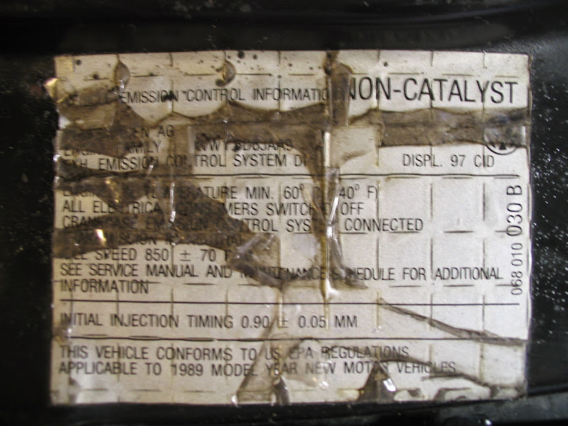

Reply #132June 06, 2014, 10:36:01 am
Re: Diesel Pulse Adapter Info Thread
« Reply #132 on: June 06, 2014, 10:36:01 am »
Somehow is maybe (?):
That '79 is of course a 1.5L, with 125bar injectors and .83mm static timing.
The 1.6 stickers can vary depending on D or TD and ECO.
« Last Edit: June 06, 2014, 04:34:42 pm by TylerDurden »
Reply #133June 06, 2014, 04:51:46 pm
« Reply #133 on: June 06, 2014, 04:51:46 pm »
Except they are measuring it at peak HP  somehow.
I took it as "for this HP time it to____ with the timing light"
Also, in the pics above I do not see a timing spec for the timing light, just the mm gauge style, so they are kind of irrelevant to this thread.
Reply #134June 07, 2014, 05:28:59 am
« Reply #134 on: June 07, 2014, 05:28:59 am »
If it were as simple as "time it to ___ with the timing light", why would VW change the spec for the next decade or more?
