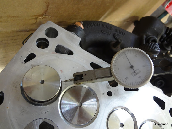

I would pull the valve and check it. That so easy to do at this point that it would be stupid not to. The valves on the these motors are pretty much perpendicular to the piston, so they will take a lot of abuse w/o looking damaged. You will need to put an dial indicator on the valve face where it touches the seat to be sure if its straight or not. Either way I would inspect the guide, but I would not replace it unless you are sure that it is damaged. The new guide will not be concentric with the seat and you will need to get it touched up if you change the guide.

OK,
I checked the run-out with the valve still in the head. Its .000175" out which is as near to perfect as it could get (yes, that's the correct number of zeros).
I may get a new lifter but with the bad luck I've had getting parts for this engine - it seems like a crap shoot.
The lifter I am putting back in has very few miles on it so I'm might just proceed.
