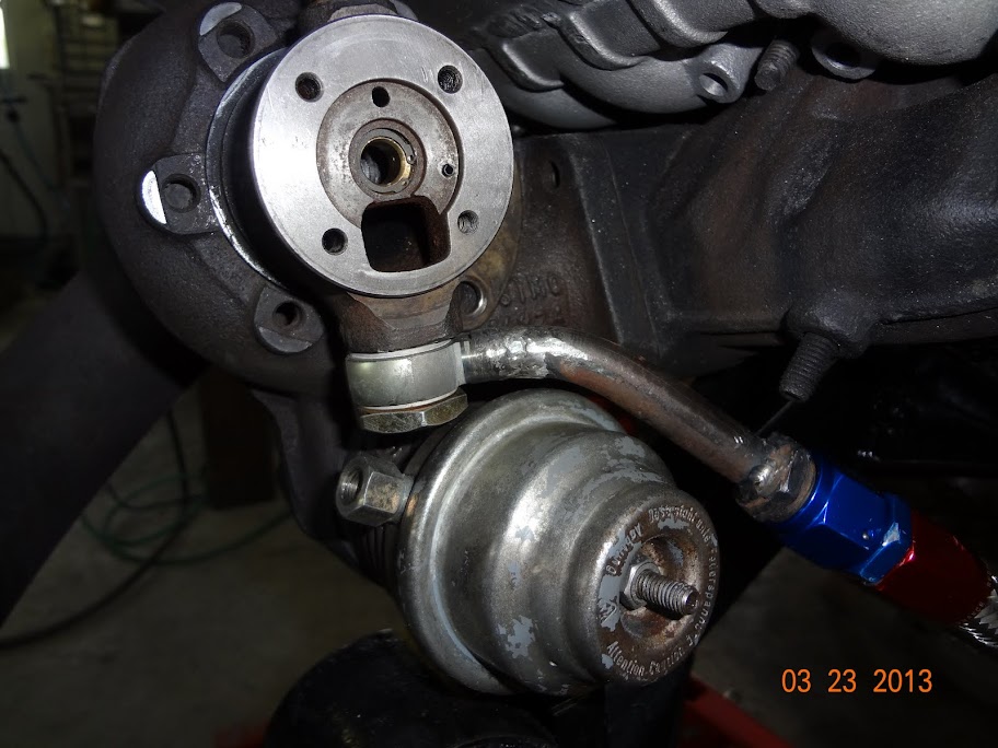

Are you running the stock K14 oil pipe out of the turbo housing? If you are, I don't think it's possible to put the drain exactly at 90 on a 50 degree application.
Not sure if this may be the cause of your leaking turbo but before I toasted my motor, I had the stock drain tube set-up and I also had a black film of oil on everything in the vicinity of the turbo in the bay.
Libbydiesel pointed that issue out after viewing a pic I had posted of the engine out. He also had several recommendations on a fix.
Here's a pic of the general fix I did.
Since that photo, I did some machining on the banjo (thinned the head a bit to put a bit more room between the bolt and the boost can) and tig-welded a curved 1/2" tube in place of the #8 JIC male. It is also is routed directly towards the block. Sorry, I don't have the photo of that handy but I dig it up if needed. From there It's hosed to a #8 fitting on the pan. Can't say if it was the out of clocking that caused it to blow a black mist all over everything but it defiantly was not at six o-clock with the stock tube.
Now I can set it at 6:00 - dead on.
Not done with the build yet so no feedback on the outcome yet.
Good luck.

Here's a photo of my banjo fitting.
I can't figure out why your's would leak unless the line is blocked somehow. The size of the huge oil exit port should allow the oil to leave the housing pretty easily without finding some other route.
I rebuilt mine and used that new 360 degree seal ring on the shaft.
Here's a closer view.
I wonder if the folks who rebuilt it left something out. Wish I could say mine doesn't leak - I'm a ways off from finding out.
