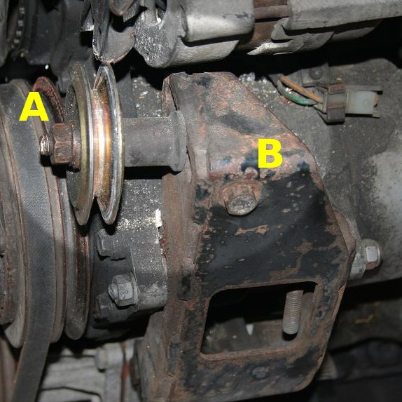

I may have had an apostrophe, lightning has just struck my brain. So that whole bit about tightening the two bolts in the right pattern? order? So that the belt does not squeak. After doing some adjustments, the belt didnt squeak as much and I got a charge! I drove around with the AC on high and high beams on. Pulled back in my space and it read 11.8v but as soon as I turned all accessories off it held steady at 12.5-12.8V. Turned the car off and held at 12.6V so the pulley adjustments seemed to have worked. The real test is to go to school and my job interviews and safely make it home without jumper cables. So my next question is, is there a procedure for adjusting the tension on the belt? Tighten one bolt all the way before the other? Tighten each one little by little?

Reply #101February 01, 2013, 06:48:37 pm
Re: 1986 Golf 1.6 N/A Crank No Start
« Reply #101 on: February 01, 2013, 06:48:37 pm »
tighten the long belt, the one that drives the a/c pump and water pump..
then, after that belt is tight, go ahead and tighten the alternator belt..
you MUST tension the long belt first..
if you tighten the alternator belt first, then go to tighten the a/c belt, it will just untension the alternator belt..
Correct.
what are these 2 bolts you speak of? there are only 2 bolts holding the alternator to the engine, neither one adjusts the alignment of the pulleys.. one bolt is the pivot bolt, and the other is the tension bolt..
Well, it does not pivot, on the MK2 w/ AC...
The alternator is held in a fixed-position by a long bolt on the bottom and a short bolt on top.
The two bolts for positioning the idler pulley control the belt tension:
Loosen nut "A" slightly.
Tighten bolt "B"  (moving the idler pulley toward the radiator) until the belt holds the alternator fan from slipping when pushing with a thumb, .
Tighten bolt "A".

yeah i understand now. touche TD, im definitely a visual learner.
