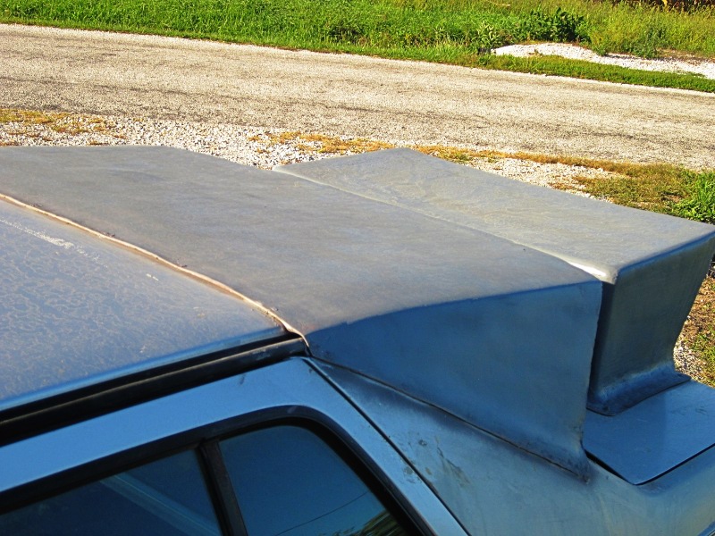

Whats.. uh.. going on with the back end there?? ;)
Pictures please :)

Ah you noticed Jeremy. It's to help recapture the balloon of air behind the car. Better performance and most importantly to get better mileage.  My last fill was 56 mpg.
I made it from pink board and carbon fiber cloth. It is hobby of mine. I'd like to make the shape to be complete but don't want to reduce the utility. The trunk lid still works.

Here are some more pictures.

I have tried doing what Wunibald Kamm proposed and has been popular on a lot of new cars. Described as a Kammback, nearly every van or SUV has a small window shade to help the air off the back window.
I used tufts on little rods (chunks of a cattle panel laying around my farm.)  to see where the air wanted to go off the back of the roof. The air went back a few inches and got all turbulent. I used that data to build my first window shade from coroplast. Assured that it would help I remade it in carbon fiber.
About 90% of my driving is with a full load,  I needed to be able to use my trunk. So after consideration, I built the park bench on the back, in front of the point the air was going into a turbulent state again.   Trying to minimize the parachute effect that is one of the biggest source of aerodynamic drag.
The car needs paint and this project is a work in progress so the carbon panels are in primer at present.

I understand your reasoning and feel that any innovation should be applauded.
I have a question though; how is the handling affected at speed? Does it make the car understeer or make the steering floaty?
Cheers
nathan

If it affects the handling I am not aware of it.
I am running Koni adjustable struts. My tires are Firestone Winterforce 155/80x13, they are just a bit taller than the stock 175/70 tires on there. I run them at 55psi.
As far as high speed handing I really don't know. Entrance ramps and back roads seem fine. I drive a fair amount on gravel and unimproved surfaces.
What I notice is when coasting in neutral it coasts further, noticeably further.

Unconventional to be sure, but I like it  ;D   Inspires me to perhaps try a smaller version of the upper part on my rabbit, depending on where the air wants to go as it spills over the hatch. Also, I've read somewhere that the underside of the car, particularly the open engine bay, is a large source of turbulent air and hence drag. I've wondered for some time now it there wouldn't be a significant improvement in the aerodynamics by installing a plate to streamline the bottom of the car, perhaps even the whole underside, depending on one's available time a resources. Thoughts, anybody?

Yep an under body panel can benefit. I drive on unpaved roads and in winter I felt anything that would trap slush and mud would be more trouble than it is worth for me. If the climate and road were better I think it would work.
Here is an interesting picture that I made showing a rabbit body in a wind tunnel with smoke overlayed on my Jetta.
The rabbit and jetta are nearly clones except for the rear.
Of course if you want the max consider this option.
He gets in the 70 -75 mpg range with a non turbo 1.6.
