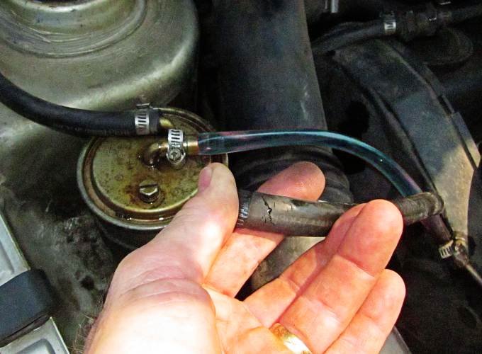

Thanks for the help all. I got a chance to open the hood and found a cracked rubber fuel line on top of the fuel filter.
Took it off and sure enough the tubing was dry inside and the fuel filter was down some. I had some clear tubing and put it on. I topped it up with a syringe and after running it stayed full.
Got lucky.
M2 Jetta TD. Northern Missouri

July 01, 2012, 08:01:28 am
366
Re: 1.6 td hard starting - Solved
Reply #11 on:
July 01, 2012, 08:01:28 am »
Here is what I found.
