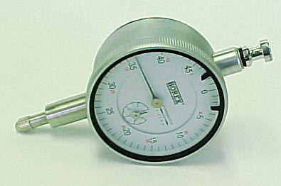

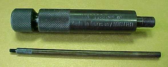

I ordered my dial indicator, holder, and tensioner wrench from Samstag Sales in Tennessee.  100% Made in Germany stuff.
I did not want to skimp on my dial indicator...stuff that needs to be accurate to 1/100th of a mm just needs quality tools IMO.
I actually re-timed my engine on lunch break today in about 15 mins haha (with a little help from this cutie on the 2nd floor I got her to watch the gauge and flywheel mark for me 8))
http://www.samstagsales.com/vwaudi.htm#diesel
Matra 2066:
Horex 2706 101:
AMF 44651
