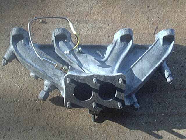

Reply #7October 09, 2010, 10:57:38 am
VWCaddy
  • 85
    • VW Caddy Page
Re: Air/Fuel Ratio gauge worth it?
« Reply #7 on: October 09, 2010, 10:57:38 am »
I would use the hole wherever the air/fuel ratio meter is supposed to be mounted to install a pyrometer instead. It will give you much more valuable information for the operation of your diesel engine.
That is what I did on my dual downpipe manifold, drilled and tapped the O2 sensor hole for the EGT probe:
'82 VW pickup, 1.9D engine, Missing LinkZ shift linkage
