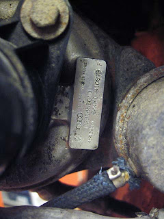

It says Made in France and "T15". It better be a Garrett T15 then.

Yes it's a GT15 from Garrett, it's smaller than a K03 from KKK.

Yep, I found it via the ID-number as well.
Turbo for Ford and VAG diesel with turbocharger Garret GT1544S OEM 454083-0001/-0002
