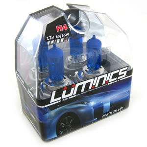

DUDE those said 10000K...probably too bright for daily driving. That would be more for your off road, spotlight, and kill deer at night ride. I thought I was nuts going with something around 6000K. I just wanted pretty blue. I think stock lighting is under 2,000K.
I bought these and I think you would have plenty of light with them.
http://cgi.ebay.com/ebaymotors/Luminics-Pure-Blue-H4-light-bulbs-headlight-bulbs-/300268060341?pt=Motors_Car_Truck_Parts_Accessories&hash=item45e95efeb5

Actually Lucas the ----K reference is to the colour temperature of the light, not the brightness of its output. These are still only a 35w bulb.
Natural sunlight is something like 4500-5000K. The higher the Colour Temperature the whiter the light.

I haven't seen HID in person but that isn't what my H4 looks like.
that is my H4 and they aren't really sealed or have pigtails, just a bulb. I would bet that it is HID especially with the ballasts and projectors there.
Oh, mine are a 55w bulb ;)
