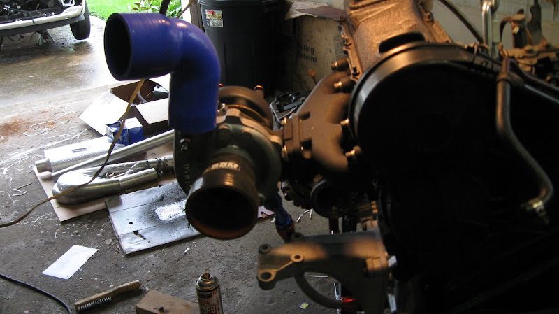

Finally got a pic uploaded, not that it really helps now.
It's gonna be close....

Update: It fit. BARELY! I had to "massage" the passenger side brakeline a bit, and actually dropping the engine in was really close- literally jammed it in there- plus it would have been smart to keep the oil feed line detached until the engine was in place... but we are in good shape now! Fabbing the downpipe will be an adventure.
So yeah, this turbo should fit with plenty of space.
