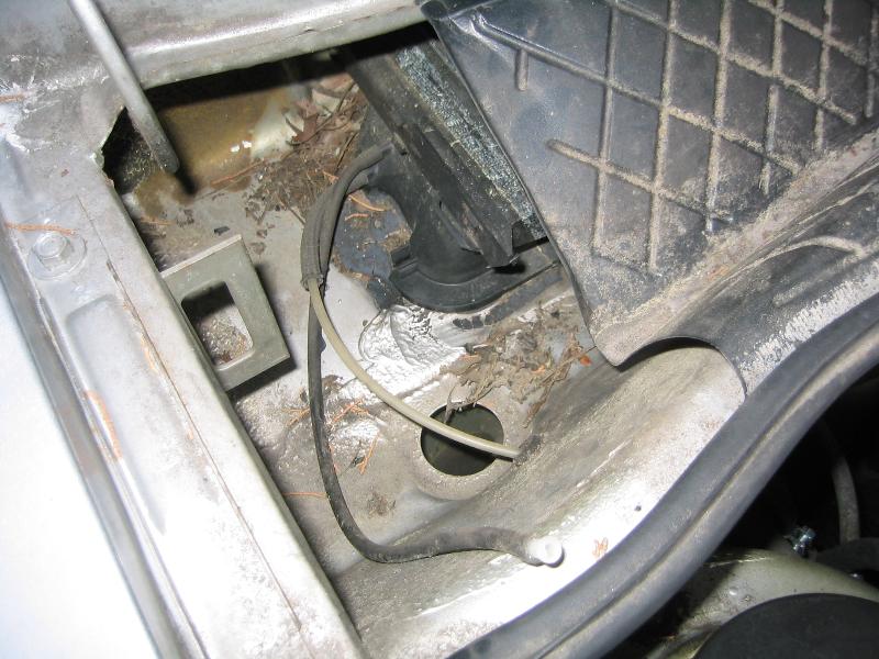

Connection at booster
vacuum pump and check valve
If I turn the car off, I can get one good jab that feels assisted, and then hard, so I think my check valve is working.
I can hear a faint whoosh like the power assist should sound like.
I'm wondering if I have a minor leak around where the vacuum line connects to the booster, perhaps a leaking booster, or something else??
