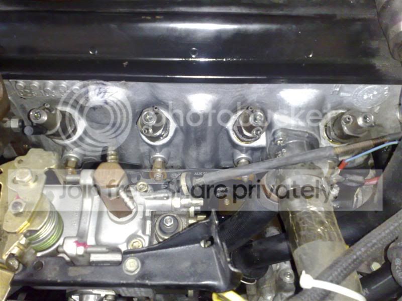

thanks for all the input guys i really appreciate it. I want to know who of you have your own gauge to set the injection pump timing with? I bought one from prothe and its in inches not mm. I thought i had the conversion figured out but if i do then my pump timing is really out of wack. Anyone else have a gauge thats in Inches, if so what do you set it to on the gauge?

And if you end up converting 1mm to be 0.039" on your new dial indicator you've got it, baby !!   :wink:

Ok thanks for the info. I got an egt gauge already and am going to put it in when i build my downpipe. I did the google conversion and it came out to .039. Thanks for the picture im guessing that is showing .039 on the gauge. I think i was reading the gauge wrong so this will help ill try it when i get hame and let youo know what i come up with.
