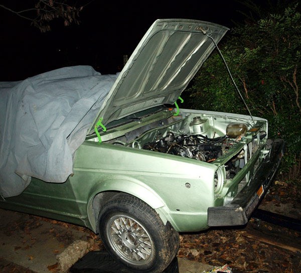

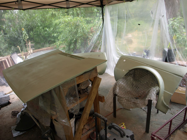

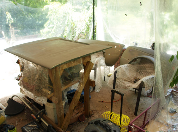

Still working on this thing.  Finally got around to installing replacement struts.  Now to install motor  ;D  Need to find a TDI pedal cluster.  Here are a couple shots from painting front panels a few weeks ago:
prep
pre-clear

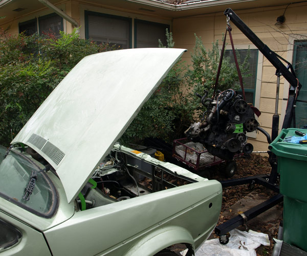

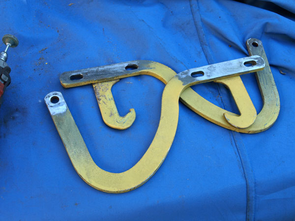

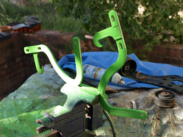

Visited podunk scrapyard for straight hood hinges and other body-related items.  Their 2 rabbits were stacked on top of dodge stratuses stacked on rims, which made for fun jungle-style access only. Also picked up drive by wire pedal.
De-oxidized and protected

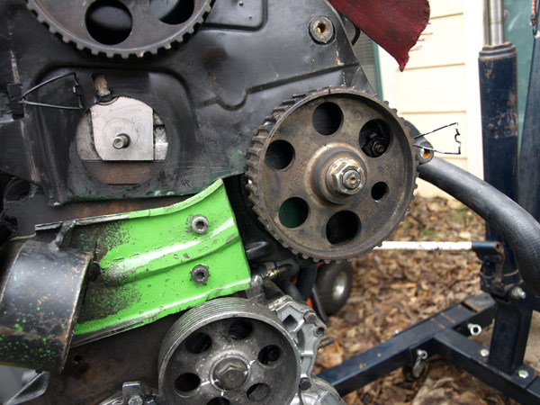

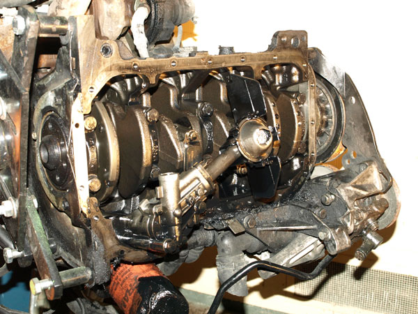

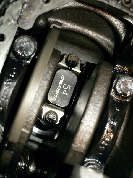

Pulled pan on the TDI.  Guts look healthy -- 7/97?

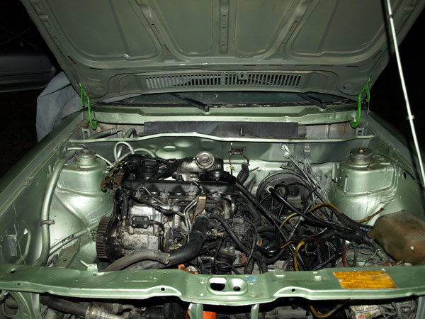

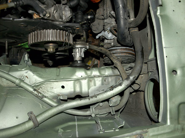

So I've finally made some progress on this project.
Modified mount/belt cover plate:
I really wish I had a load leveler.. Had to remove hood of course
In!
I'm a little concerned with how close the waterpump pulley is to the frame.  It doesn't rub, but it's really close.  Might require some modding.
Now to sort out the wiring and begin endless cosmetic tweaks

After re-aligning the back transmission mount the water pump pulley is nowhere near hitting the frame.  Been rebuilding axles, installing lighting, trim, etc.  More photos to come

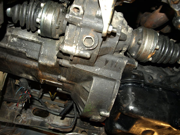

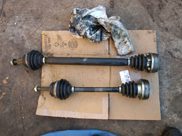

"rebuilt" axles:
in

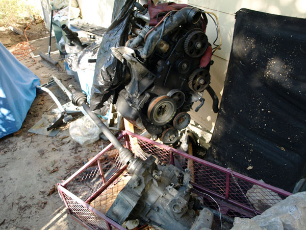

Rebuilt shift linkage.  For some reason installing axles in this thing with the engine/transmission already in as a unit was a real PITA.  I had to unhook one of the mounts and tilt the engine to get the pass. side axle to connect.
My engine came with half of a downpipe, so I am fabbing the other half that connects to the flex pipe.  Then it's on to wiring, and finally, driving. Progress has been slow lately due to lack of garage and abnormally cold/snowy weather.
