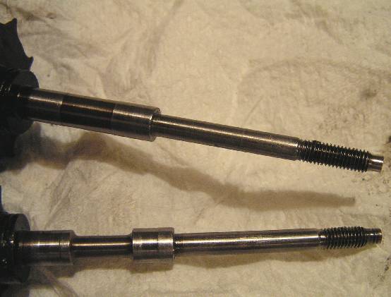

From what I have been reading, it appears as if the shaft on the 17 is superior to the 15.  Any additional concerns to going the 17 route over the 15?

On both the .46 Vnt 15 and 17 cold sides I have here, I must say they look identical. I had heard the 17 was just a re-named 15, maybe when they upgraded the shaft, and I'd believe it. The one in my truck is a .43, which is obviously different, and was from a non-VW app.

Quote from: "jimfoo"
I found the post about the shaft, low and behold it was from you!
Functionally they are the same, but the shaft is necked down between the two bearing contact points on the 15, and is a constant size on the 17 and above.
Are you saying the housings look identicle or the actual wheel?

Housing and wheel both look identical.
