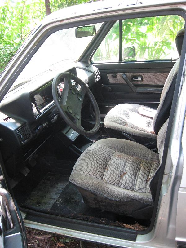

Well I went to look at it today. Guy says he's got the water drained out, but that the radiator fans aren't coming on, and it needs either new fan or switch or both. Engine bay looks good, body is straight and rust free, but windshield gasket is all sorts of screwed up, and its been sitting for about a year. Interior is gross, mold on the carpet and on the headliner, especially around the sunroof.
Interior is really scaring me away - I've had to deal with water and mold before and its not fun. Basically looks like I'd have to gut the interior and replace, not sure where I could get replacement stuff cheaply.

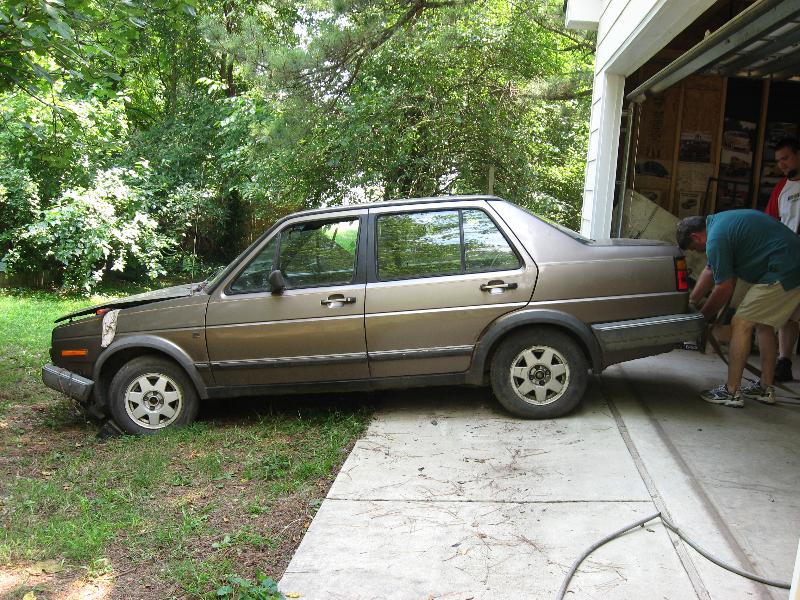

The 86 going into the garage:

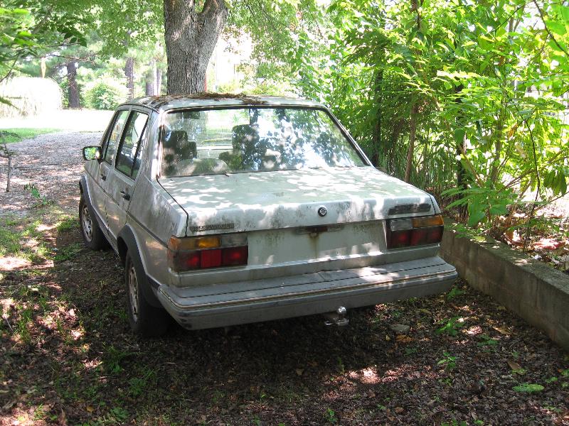

The Mk1 before cleaning:

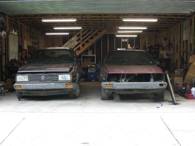

Parts cars in the garage:
The Mk2s are getting torn apart for parts, some local VW friends are coming over this weekend to get stuff and strip them down. Any leftovers will probably go up for grabs online.
Once the Mk2s are gone, I can pull the Mk1 into the garage and start working on it.
