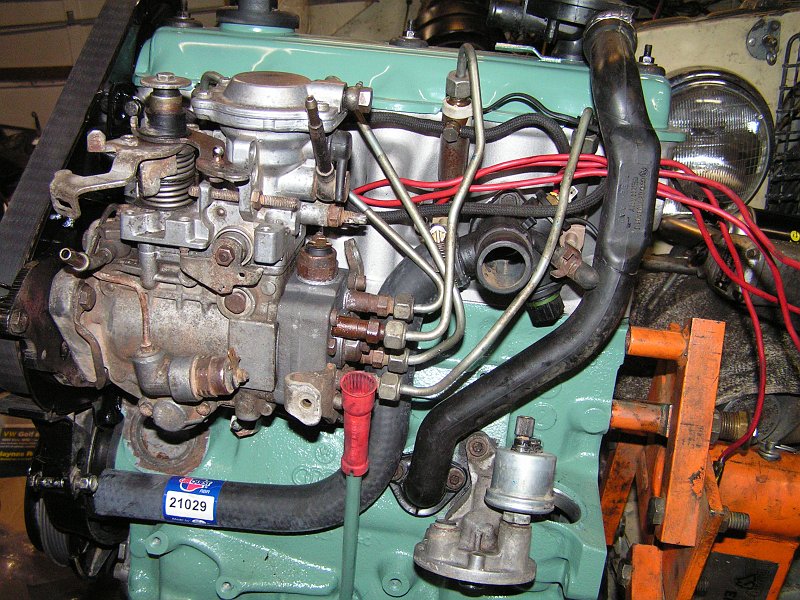

Mine has a different part number than the one posted above, 028 129 101.
Just to make sure, you want the breather pictured on the top right of the valve cover? Sorry but I don't have a better picture of it.
Reply #10April 16, 2008, 10:30:35 am
Valve cover breather
« Reply #10 on: April 16, 2008, 10:30:35 am »
yours is different Jim because you have 2 pipes going into it, the 1.6s only have 1. All you would have to do is block the one off

I'll keep that in mind.
And that head sure is pretty!  Personally I would have gone with Deutz Green, but for your application your color choice is probably perfect.
