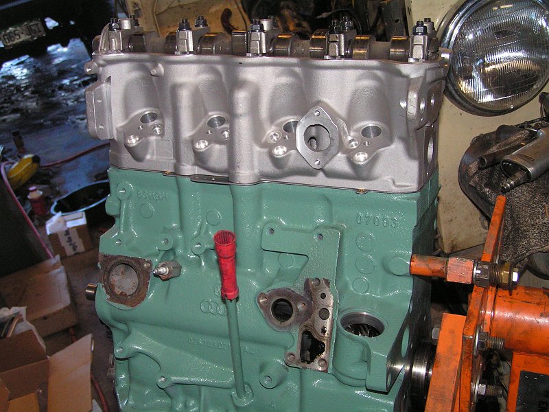

The best image with the water pump removed is this one.
Does pressure build up in your cooling system if run for a short time when cold? If so, it may be the head gasket. There shouldn't be bubbles as far as I know, but my setup is different, and I wouldn't be able to see bubbles if I got them

Thats a perfect picture thankyou! you said about pressure building from cold? I does, but not a large amount, if i open the cap before i start it to relieve any residual pressure then start it, after about 2 mins of tickover it will sound like a bottle of pop when i open it, just a small pphhttt.
