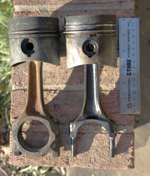

Looks like boreing out the small end of the 1.5 rods to accept 1.6TD pins might be an option.
The 1.6TD rod is on the left 1.5 rod on the right:
The 1.6TD rod has a thicker fillet on the base of the small end:
I have to remove the bushings and make some measurements yet.  But looks like I'll be useing 1.6TD pistons and block with the 1.5 rods and crank.

thats wierd Karl! seems that the 1.5 rod is longer then the 1.6?
i thought it was the other way around?

1.6 stroke: 86.4mm
1.5 stroke: 80.0mm
the 1.5 rods are longer by 6.4mm or 0.252".

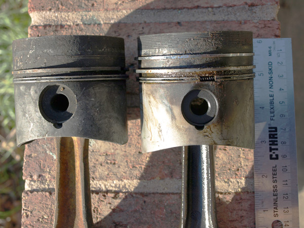

ok, has anyone payed attention to the pistons yet? 1.5 pistons are taller from the wrist pin hole to the top of the piston. 1.6 pistons have the hole closer to the top, so it will have ALOT less compression if someone actually gets 1.6 pistons to fit on 1.5 rods.

Here's one of the non-turbo 1.6 pistons (left) that came with my 1.6TD block (separately) next to a piston from my 1.5 (right):

Well, looks like the next step is to get a 1.5 piston and measure the actual pin height difference between the 1.5 piston and the 1.6TD piston, and then get the block decked when its getting bored to first over.

Pinhole Measurements
« Reply #69 on: March 03, 2009, 07:42:37 am »
EDIT:
Looks like the pin hole diameters are 22.5mm (1.6L) vs. 24mm (1.5L).  Distance from the bottom oil ring groove to top of the pin hole on each appears to be 1.25mm (1.6L) vs. 4mm (1.5L).

the distance is 1.305" from top of wrist pin hole to piston crown on a 1.5.
