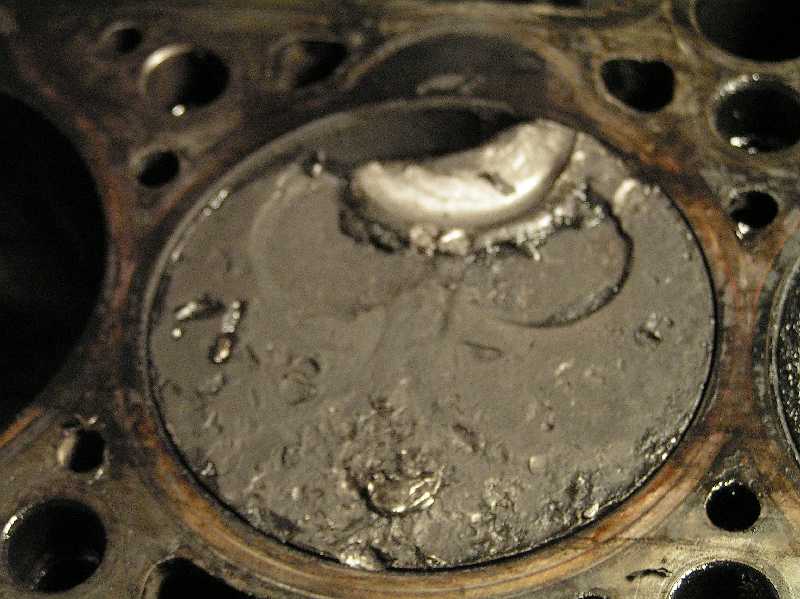

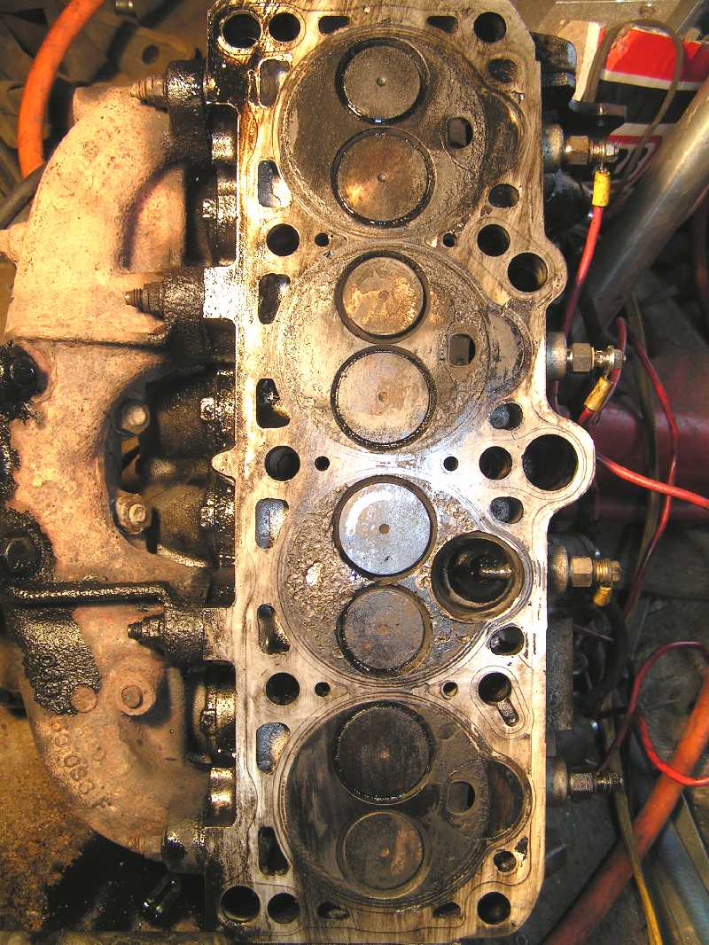

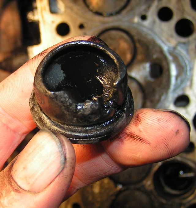

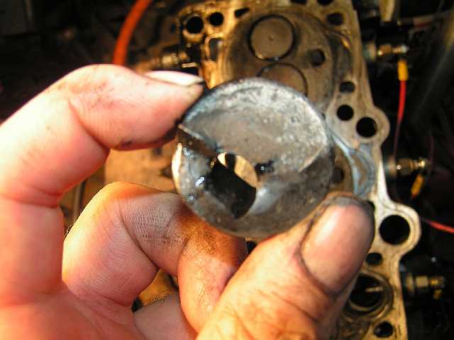

Well, I guess I'll let the pictures do the talking... :evil:
Theories? Caused by excessive oil in the cylinder, bending the aluminum under pressure, loosening the cup? 2 and 3 have a lot more cylinder wear though amazingly no big scratches. The ridges on 2 and 3 are much bigger compared to the almost imperceptible ones on 1 and 4. I'm thinking this is from when the intake hose to the turbo disintegrated, sucking in dirt and crud for who knows how long. It would make sense that most of it would go into 2 and 3. Also note the lack of cracks between the valves despite the high temps I would run at.

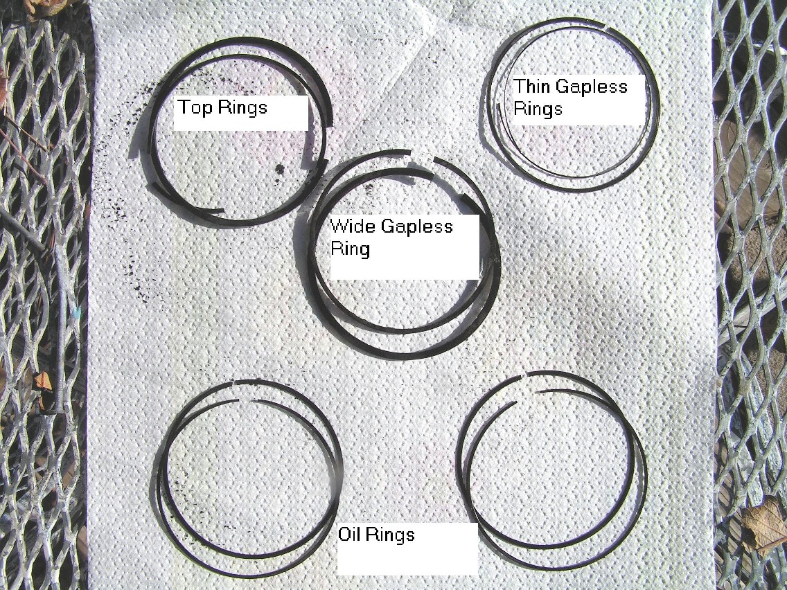

Hmmm, could this be where the blowby was coming from?
Just a bit of wear on them. The thin ones in each set are from #3, and the wider normal looking ones are from #1. I think this kind of confirms my feeling about the dust and dirt that got in as being the cause of the majority or maybe all of the damage. I have no way to directly measure the bores, but the #1 ring in the #1 cyl had a .040" gap, and had greater than .075" gap in #3. I didn;t feel the need to find the actual gap as it was just plain huge.
Amazingly the bearings don't look very bad at all, but I had epoxied a magnet under the oil pickup, which had LOADS of ultra fine metal sticking to it. The #3 piston was very scored, and I actually had to pound it out as it was sticking enough that I couldn't pull it out by hand.

Yikes that is ugly. Maybe the burning oil caused too much pressure in the precup and it eventually blew out.
