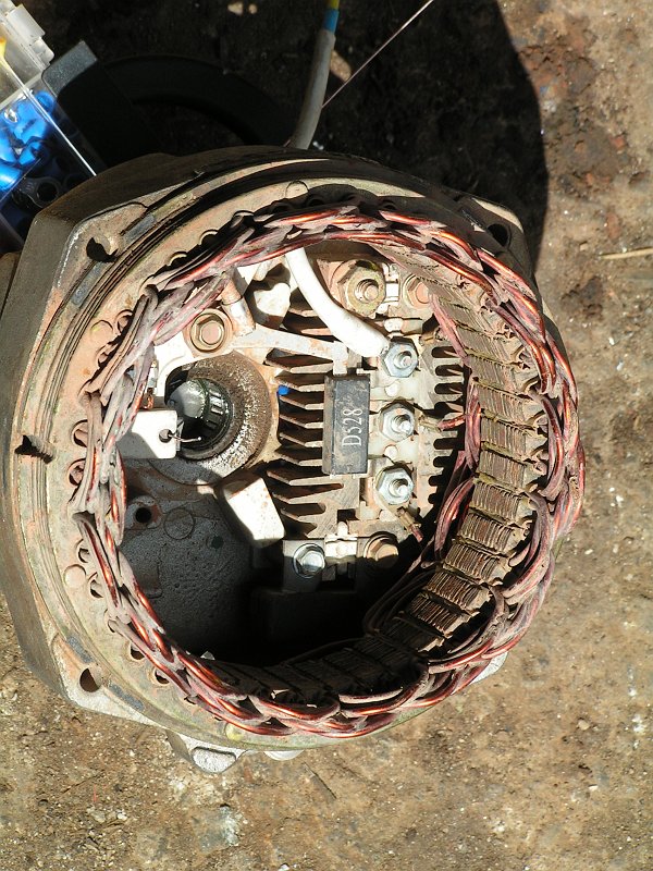

You can also just take an alternator apart and hook a wire to it on any phase just before it goes to the diodes. On a Delco alt, it is a stud with a bolt, so is very easy to do, but I'm not sure about a Bosch.
