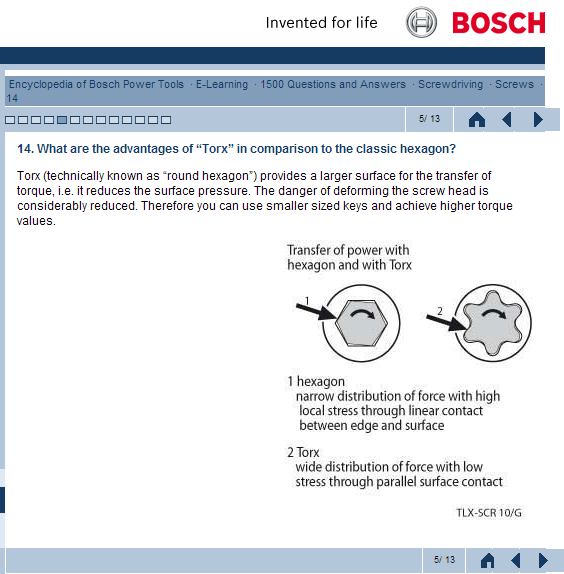

This is torx, but XZN has similar properties.

The other part of the equation is the bit has less strength behind it than the Hex key does. Also if the grain of the metal in a torx fastener is questionable as Toby has said happens a ton then the points are more easily rounded and easier to strip than a similar socket head cap screw *Allen* as some call them. The triple square and double hex I have found worse yet when you get a sub par batch of metal in them.
